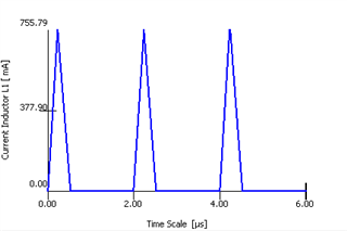

  • Hey Sean,
    Theoretically what would be happening to your design is it would switch between PFM and DCM for the very low currents which would be pretty similar in efficiency.
    PFM is effectively putting a hard limit on how low the peak can go, waiting until the peak gets high enough to start the next cycle.
    DCM will let the peak get lower and lower, but both have the benefit of not having negative current.
    Take the below graph as a random example:
    DCM would reduce the 755 mA peak as current got lower by reducing the duty cycle.
    PFM would keep the peak the same, while increasing the period of 2 us.
    Regardless you would have the benefit of the efficiency over CCM
    A PSPICE simulation with margin would likely be the easiest way forward for doing WCA on what you want.
    PFM being variable frequency makes it hard to define everything for WCA analysis.
    Daniel
