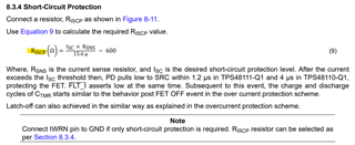

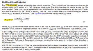

I have a customer evaluating the TPS4811-Q1 (Specifically TPS48111-Q1) for a project and we ran into a discrepancy that we're hoping you can help to provide some clarity on. See details and questions below!
There seems to be two “Short-Circuit Protection” sections with conflicting formulas for R_ISCP: Sections 8.3.3 and 8.3.4. Do you know which is correct? Also, please note the incorrect PN highlighted in 8.3.3.
On another note, can the efuse cutoff FET drain and source be used for short-circuit/overcurrent protections like section 8.3.3 describes (instead of using a sense resistor)?
