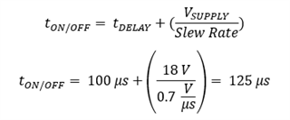

Can we use the TPS1H100 like this?
Using a 300HZ 1% duty cycle PWM to control the IN pin to get a 300HZ PWM output, Can our device meet their requirements?

Frequency of 300Hz will result in a period of 3ms, using the equation below and values from the datasheet the device can operate at 125μs.
At 1% duty cycle that would be a 30μs period, which would be too fast for this device.
