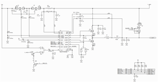

  • Hi Christian,
    I am using a special board that we developed ourselves, I have attached the schematic of the BMS below.
    We have about 30 boards, some of them charge the battery well but some of them do not charge the battery, sometimes the boards that work do not work.
    Another problem is that if we do not connect a battery to the panel, the system never works with ac supply. It always chooses the battery as the supply source. But we see that the BMS detects ac supply in the "AC Adapter Indicator" regulator
    We tried to use the learning mode but after discharging the battery it would not charge.
    We don't know where the problem is and where we should focus.
    I don't know what else I can say, please feel free to ask any questions. I'm here to provide more details.
    In addition we use 3S battery pack.
    Thank you, Best Regards,
    Fatih.

    We divided the circuits into two categories, the ones we think work “Circuit type 3” the ones we think don't work “Circuit type 1”

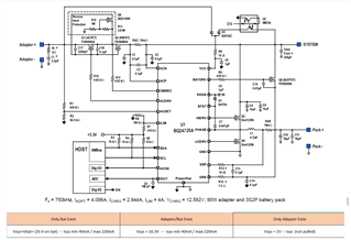

  • Hello Christian,
    We have built the example circuit as seen in the photo. Our Vin corresponds to your Vadapter, and our Vbms corresponds to Vsystem.
    Our adapter voltage is the output of an AC-DC regulator, ranging between 17.80-18.30V after the initial moment.
    When there is no Vadapter present in the circuit, Vsys equals Vbat. Therefore, we mentioned that Vsys is the voltage of the 3S battery when you asked about it.
    When adapter voltage is applied to our circuit, Vsys becomes 16.3V. The current we draw varies depending on the operation of the circuit, ranging from a minimum of 40mA to a maximum of 220mA.
    Could you please clarify exactly what you mean by "voltage/current"? Are you referring to the ohm value or something else?
  • Hello Mehmet,
    Thank you for the clarification,
    I see no obvious issue with your schemetic that would cause the adpater to drop from 18V to 1V at the system output. Have you tried using a different adpater, such as a power supply, to confirm thet it's not an issue with the adapter?
    Christian.
