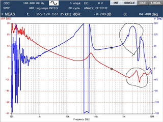

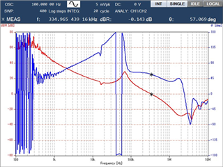

    I have measured the G-Φ characteristics using TPS62873EVM-144 (2phase of TPS62873).
    The +0.4V gain curve is changing to increase around 1.2MHz,
    The phase curve is significantly advanced between 1MHz and 2MHz.
    It would be helpful if you could comment on whether this characteristic is OK or not.

    0.4V
    0.6V
  • Thank you for sharing.  Those bode plots look much better.
    The calculator does not calculate phase margin.  It uses the D/S equations, which are designed to give a stable design.
    Yes, the calculator is primarily setup for meeting a given load step.  If you have a constant current load, then you can skip those inputs and just focus on the Rcomp and Cout cells.  With a chosen Rcomp (which is usually very low, as you chose) make sure your Cout is greater than the required Cout.
    In your 0.4V plot, I would not worry about this.  It is at a very high frequency, and above the nyquist limit of bode plots which is fsw/2.
    You might retest the 0.4Vout circuit with a 1.5 MHz fsw.  You are probably reaching the minimum on time at 3 MHz.  This is ok for the device, but may make the bode plot not look nice.
