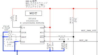

Dear all:
our original watch dog IC is S-19400G28A-K8T2U4  ABLIC, we will change it to new  Alternative part is TPS35-Q1 serial ,  full  MPN:TPS35CA**LAEDDFRQ1(** is unknow)
In order to get closer to the original design parameters , we select TPS35CA**LAEDDFRQ1.
but there are some question such as:
1. according to TPS35-Q1 spec we choose the MPN TPS35CA**LAEDDFRQ1 as below: see red color
Threshold Voltage is need 2.8v ,this type is it  provided? ,  I can't confirm if 2.8V is available by naming nomenclature show as  below
2.Consider our original design and requirements, the PINOUT C is only options,but has some question as below
2-1:we must add new 3 ports is SET0,SET1,/MR from original(ABLIC S-19400G28A-K8T2U4)  for new design, cause to new Circuit must be redesigned
if SET0,SET1 has no use anymore ,then it will be set to scaling=1 , like bit[0,0] ,  How to deal with these 2 ports?Tie to GND, or  anything to note ?
if  pull it up ,how to do with , such as pull up Resistance Value is ?
2-2:WDI trigger is change to falling edge trigger from  rising edge before ,what does software to  pay attention for?
2-3:the t_SD timming is no need , it is ok?:marked with red line show :
and what dose this t SD time delay function and it is must  necessary?
our original design of ABLIC S-19400G28A-K8T2U4 IC  is no equipped with it
our original design of  circuits  detail is:
the VDD=3.3V
MCU:RH850(Renesas)
TWD=11S
TD=65.2ms
WEN is need
AEC-Q is need

  • Hi Shaofei,
    Thanks for your question.
    1) Yes, we do have the 2.8V threshold variant. It should be "36" ((36 x 0.05) + 1 = 2.8V). The MPN will be TPS35CA36LAEDDFRQ1
    2.1) Yes, SET0 and SET1 pins can be directly connected to ground to get the watchdog timeout scaling x1.
    Since L=10 sec, when SET0= 0 and SET1 = 0, twd = 10 sec x 1= 10 sec
    If you need your twd =11sec (min), I would recommend connecting SET[1:0] = 0b'10, this way twd = 10sec x 2 =20 sec.
    2.2) A falling transition (edge) must occur at WDI pin before the timeout expires in order for RESET / WDO to not assert.
    2.3) tsd is the watchdog startup delay and for the MPN that you ae considering  (TPS35xA) there is no tsd delay.
    And if you don't need MR functionality, the MR pin has 100 kΩ pull up to VDD. The MR pin can be left floating. The internal pull up makes sure the output is not asserted due to MR pin trigger.
    Hope this helps! Please let me know if you have further question!
    Sila

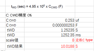

  • HI sila
    thank you for your support
    If we want to use this model,  if  set 10S, we will use the PINOUT C of external capacitor setting , In this case, the model will be TPS35CA36ACADDFRQ1,
    that will 8X scale and cap is setting to 1.25S by these Calculation,tWD result is 10.0188S
    by set[1:0]=0b'10, tell me how resistor of parameter is need to setup? is  also same as /MR with 100Kohm pull up?and  tie it to VDD 3.3V? or go to GND .
    and howmuch is  the pin current value ? because our aplication is in car informatain audio system, VDD 3.3V is from Battery bu +12V->BU 3.3V
    so must pay attention to  the current consumption under the backup conditions
    Here are the options is below: Please confirm again if TPS35CA36ACADDFRQ1 is any problem
