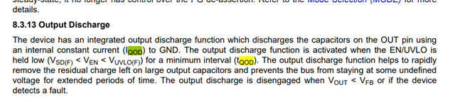

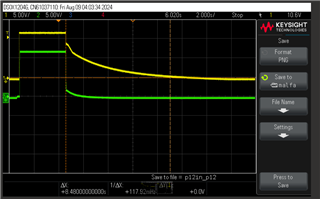

I am using TPS25985 as primary efuse. There is no stacking. My question is: with 166uF output caps, after I drop EN to 0V, the 12v output takes nearly 10 s to decay. I don't think the quick output discharge is working.
With 20.6mA QOD, I expect maybe 0.2 s decay.  Did I miss anything here? BTW, the output is another load switch, of which the output drops much faster than the output of TPS25985 efuse.
yellow trace is output of TPS25985, and green trace is the output of 2nd load switch after TPS25985
