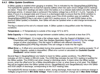

    I see that the GPCCHEM tool was used to chose a chemID for this device. Can you please confirm that the chosen ID has an error less than 3% detailed in the report given from the tool?
    Looking into the log file, I see that there is no data for the initial discharge, which makes it slightly difficult to check all of the things that could be happening, however there seems to be two OCV measurements being taken in the correct spots, but the Qmax is being invalidated for one of the reasons listed below:
    Can you please confirm the orientation of cells being used for this application? I see the DA Config is set for 1S.
    Anthony Baldino

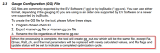

    Regarding step 5, After loading chemdat12_ID5167, do I need to load the gg_out.csv.
    Are there any difference between gg.csv and gg_out.csv.
    Mulin
  • Hi Mulin,
    I would load the gg_out.csv. Below are the differences between the gg.csv and the gg_out.csv:
