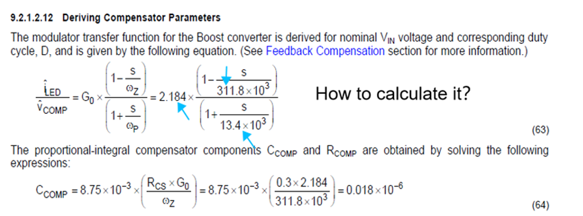

Our customer has raised some questions about the TPS92692:
1, In the datasheet table2 gives the calculation formulas for G0, wp, wz, could you please tell me about Vo, ILED, D in these formulas Is a typical value or a maximum or minimum value?
2, In the applied example in page 37, the value calculated by me and the customer is not 2.184, 311.8kHz, 13.4kHz for G0,wp and wz based on known condition so far. Could you pls suggest the detail on the calculation process for those indicator? Includes the value of L, RIS, Cout, RD, Vin, Iled, Vo respectively.
