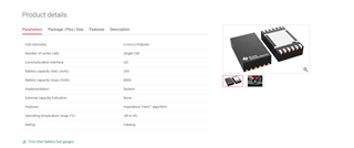

    I do not see any issue with your configuration. Did you mention how you determined the chemID for the gauge is a good match for the cells you are using?
    Robert.
    https://www.ti.com/product/BQ27441-G1
    The above are the specs and it is as per the battery parameter.
    The product folder contains the specs for the device, you are correct.
    Can you explain what your concerns are?
    Diego
