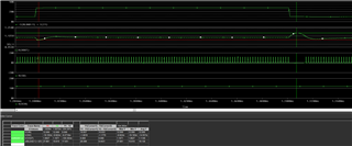

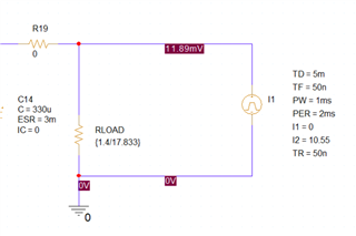

    So, for 2. I've tried this. I retried it. Below is the configuration at the load:

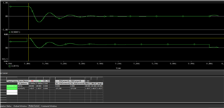

    Here are the results from the simulation. The top Plot is vout and the bottom is the current from R19( I used this series resistor in order to get a plot of the full load current instead of a piecewise one. )
    You can see initially the current jumps and the voltage holds then shortly after the load current and output voltage drop.
    I'm not sure what to interpret here.
    1. Is this the actual response and if I let the simulation run longer it is slowly going to respond milliseconds later?
        I'd have thought the response would be a little closer to accomplishing the output in this time window. Note I originally ran this setup as you suggested before I sent you the simulation the first time and let it run longer and I never saw the output recover, I think this was a 15mS window vs the current 6mS.
    2. Is my setup incorrect?  Note I have 187K resistor on my ramp pin. In the actual design I am not using this pin at all.
    Specifically, I am asking can you explain what I am seeing when the current source turns on.
    Should I expect this response from the switcher, or am I configuring something in the circuit incorrectly?

  • Hi Matt,
    That's strange. From the screenshot attached it looks like your configuration is correct. This is not the expected response of the converter and it should be able to simulate this step. I will match your schematic and share my project with you by Monday. My hunch is that something small is up with the schematic.

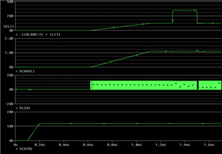

  • Hi Matt,
    I did get the chance to look into this today and I'll share my findings below.
    It seems that the convergence errors were persistent, unless I ensured the following:
    1. Remove the 0ohm R19 resistor. In order to measure the combined current of RLOAD and I1, you can do trace math by right clicking on the plot, Add Trace, then filling in the trace expression box with I(RLOAD)+I(I1).
    2. Go to simulation settings and ensure that Skip initial transient bias point calculation (SKIPBP) is selected
    3. Use a nearby voltage setting to 1.4V. I was unable to converge the simulation when the feedback resistor divider was connected to the VOUT node. However, when VOUT is tied directly to RSP, the simulation converged successfully. This is unintended, but to validate your transient condition, you can use all of the same BOM, except use the 1.1V VOUT setting by setting VSEL to 187k. The overshoot and undershoot performance will be comparable to 1.4VOUT.
    Alternatively, you may use the excel calculator tool to estimate the load transient performance at 1.4VOUT by filling in your load step size, rate, and viewing the resulting Overshoot and Undershoot calculations.
    Here are my results and schematic from doing a 1.1V load step using the adjustments listed above.
