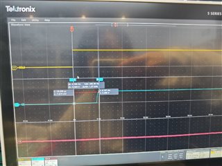

Ideally, when SEL2=0, Vsns≈0, and when SEL2=1, Vsns=Isnsfh*Rsns≈5V. However, we observed that the voltage at the SNS point takes about 4ms to change to 5V when SEL1 switches from 0 to 1, and quickly changes from 5V to 0V when SEL1 switches from 1 to 0. Why is this? What is the chip doing in these 4ms? How can we set the switching time of SEL1 and the sampling time of SNS to ensure that the correct voltages of the two channels are read?
The yellow line is SEL2, and the blue line is the voltage on Rsns

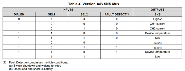

    For reference, here is the truth table for the fault output:
    When SEL1 = 1 and SEL2 = 1, the output state of SNS is undefined so this is likely why you are seeing the quick/sharp decrease when toggling SEL1x.

  • I can't understand your answer. SEL1 is always pulled down to ground, and my question is not why SEL2 drops quickly when switching from 1 to 0, but why SEL2 rises after a delay of 4ms when switching from 0 to 1.
    In addition, the supply voltage is 14V, which is a constant voltage, so why is it quicker than 4ms? What is the connection between the two?

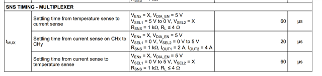

    The SELx pins are just logic level digital inputs and would not output any voltage or current outside of what the MCU connected to said pins sources. I would expect the device to detect the open load condition quicker and report the fault via the SNS pin when switching SEL2 and SEL1 within the following timing parameters:

  • Sorry, I made a typo。I mean "my question is not why SNS drops quickly when SEL2 switching from 1 to 0, but why SNS rises after a delay of 4ms whenSEL2  switching from 0 to 1."As you can see in the first picture I posted, SNS did not report the error immediately, but only reported the error 4ms after SEL selected the channel.

    So it should only take tens of microseconds... nowhere near the millisecond range.
