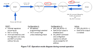

  • Hi Bin,
    Apologies for the confusion (edited my previous response). I misunderstood your question for UCC5880 which can be used without SPI (but not recommended) vs UCC5870 which cannot be used without SPI because you need to send commands to enter ACTIVE mode, the detailed procedure is mentioned in the datasheet SPI section.

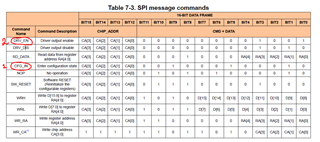

  • Hi Bin,
    You would have to send CFG_IN command first to enter configuration 2 mode and then send DRV_EN command to enter ACTIVE mode.
