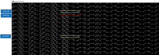

During our customer's test, we sometimes see that the bq measures a lower value for cell 11 and a higher voltage value for cell 12. After a shutdown/Reset it works fine again.
In the following snapshot you can see the cell voltages from Cell1 to Cell 13.
The customer charged the bike in the evening. At the next morning after starting the bike the measurement above was taken.
After a restart the voltage measurements were equal again.

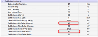

    I also think that there is no reason to start balancing. The Balancing is managed by the bq and should start if there is a disbalance of more than 40mV.
    The battery I have here is well balanced. When no charge current is flowing there is a difference of max. 8mV. While charging with about 5A the max difference is lower than 20mV. So I think in this case there is no need to balance.

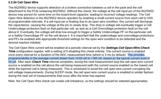

    Is it possible that the open-wire check can cause a current of about 3 mA?

    Is this voltage difference in Cell 11 and Cell 12 only happening once before you reset/shutdown the part or does it still occur after you shutdown/reset the part?
    While an open-wire check draws current, I do not think it should be drawing 3mA.

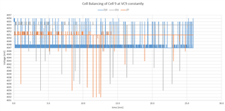

  • Hello Alexis,
    thanks for your answer.

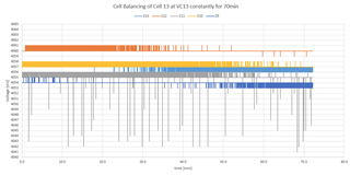

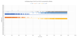

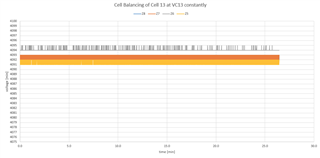

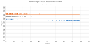

    Yesterday I wrote that I have balanced the cell 11 constantly.

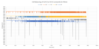

    Now I have balanced the cell 13 constantly/permanently over almost 90min.
    In the 3 charts you can see all 13 cell voltages:
    In the first chart you can see the cell 11 in gray. It looks like there are voltage jumps of around 14mV.
    The other 12 cells do not have these voltage jumps.
    Voltage jumps can be seen on one cell, although a completely different cell is balanced.
    Could this be an indication for our issue?

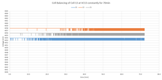

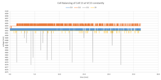

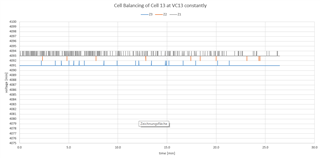

    I have increased the sampling from 1000ms to 200ms. And did the same logging:
    Thanks for helping us.
    Regards, Klaus
  • Hello Klaus,
    Thank you for sharing your results again. The voltage jumps of around 14mV you are seeing for Cell 11 when you are balancing Cell 13 seem normal/can be expected. This is explained further in
    Section 2.5 Voltage Measurement Accuracy During Balance in our Cell Balancing With BQ769x2 Battery Monitors application note.
    Could you also try balancing several other adjacent cells to see if anything looks strange that could be causing the issue?
    Also, could you share the .gg file from bqStudio?
    Alexis

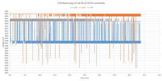

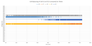

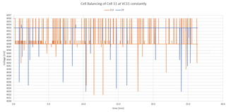

  • Hello Alexis,
    Am I understand right that the measurement of the top cell is impacted by balancing?
    In our case it is cell 11. Or am I wrong?

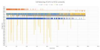

    First I have done the test above with balancing cell 13 constantly/permanently with a other battery which has almost the same behavior our customer mentioned.
    In the first chart you can see that also cell 11 (gray) is impacted.
    In the next steps I will use the original battery again:
    If I balance cell 12, then cell 10 is impacted:
    If I balance cell 11, then cell 9 and cell 13 are impacted:
    If I balance cell 10, then cell 13, cell 12 and cell 8 are impacted:
    If I balance cell 9, then cell 13, cell 11 and cell 7 are impacted:
    I would like to share our *.gg file with you. Is it possible to do that in a private message? I have tried to send it to you. But I think I am not allowed to do.
    Regards, Klaus.
  • Hello Klaus,
    The accuracy of the top cell measurement can be impacted by the time constant of filter components and the IR drop, however, the other cells could have some measurement disturbance during COV/CUV checks. That is mentioned a bit more briefly down in that section.
    Thank you for sharing those further screenshots with cell balancing other adjacent cells. Can you also try sharing the .gg file again? I think you should be able to do that in a private message now.
    Alexis

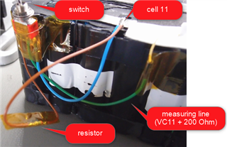

  • Hello Alexis,
    thanks for your answer an check of our *gg file.

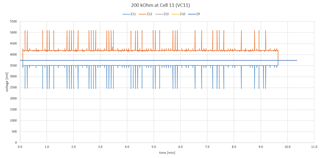

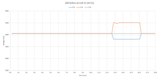

    I have made some test with a additional resistor in the measuring line at cell 11. I have made it
    switchable. So I can add the resistor and remove in a short time.
    The resistor value was between 10 MOhm and 200kOhm.
    I can say that you were right. That is a possibility for our issue.
    If I use an 200 kOhm resitor, I get following behavior:
    As you can see Cell 11 goes down and Cell 12 up. Cell 13 for example stays equal.

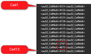

    This are the values from the error log:
    Maybe that is the error which our customer see sometimes. If this is right, the measuring line must have a contact resistance between 200 kOhm and 475 kOhm.
    What do you think?
    I discharged the battery to about 3,7V/cell and repeated the test. Now the BMS do not run into a COV and tests runs for minutes. As you can see the spikes. This should be the COV/CUV check again, right?
    Thanks, Klaus.
  • Hello Klaus,
    Thank you for checking the loose/brief wire connection!
    What do you think?
    I agree that I think this sounds like it is the error your customer is seeing.
