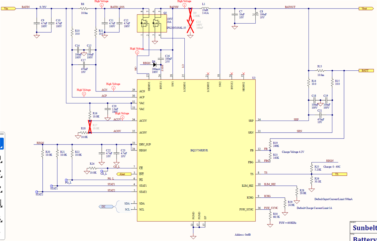

My customer would like to use BQ25756.
their schematics as below
In their use cases, the Vin will always be > 9V and the battery is 1 cell Li-Ion battery.
Therefore, in this application, the BQ25756 will be operated in Buck mode only.
In the Buck mode only application, do we still need the Q3 and Q4 ? Will the charger still be functional if we don't have the Q3 and Q4 ?
  • Hello PY,
    Thanks for working on this. The BQ25756 will not work without all 4 switching FETs.
    You can use the BQ25820 instead. The BQ258520 is a buck-only version of the BQ25750 and can be operated without the power path FETs.
    Let me know if you have any questions about this.
