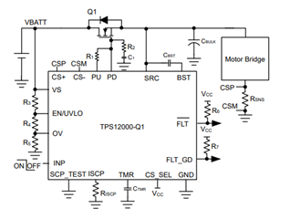

Ref design:

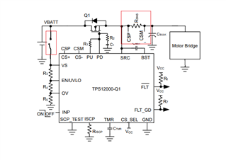

Proposed design for our project:
We want to add a switch for VS and move the sense resistor in order to minimize leakage during shutdown. Is this something that we can do?
