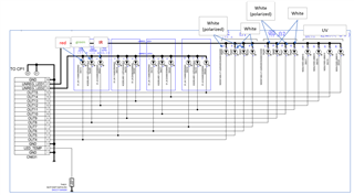

The circuit diagram is shown below.
There are two types of power supplies for the LEDs, as follows.
They are separated for each LED. The power supply is switched for each LED that emits light.
UNREG_LED1: White, white (polarized), UV
UNREG_LED2: Red, green, IR

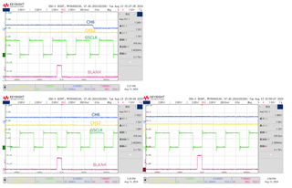

Below are the waveforms observed on a prototype board.
The relationship between GS_CLK and the BLANK signal is that a BLANK signal is inserted every 4096 GS_CLKs.
We were able to confirm that the phase of this GS_CLK and BLANK signal differs when the power is ON/OFF.
In Figure 21 of the datasheet, the phase relationship is as follows.
(Question)
Is there a possibility that a malfunction will occur if the timing "Tsu4" spec of 10ns or more is not met, or if the BLANK signal rises before 4096 times?
Are there any other reasons why this problem occurs?

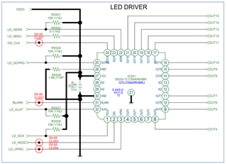

    1. For your schematic, I'd like to know why there are some resistor between pin and pin, like R5501, R5526, R5527, R5528.
    2. For your capture waveform, I'd like to know why the BLANK signal toggled during the the high period of GSCLK on the first waveform.
    3. For your whole problem, I am not sure my understanding is totally correct. Do you have any report or contact information can share to me?
    BR, Jared
  • Thank you for your reply.
    The resistor in the circuit diagram is a pull-up resistor. Is there a problem?
    In the customer's ASIC circuit, GSCLK is input even during the period when BLANK=Hi.
    The BLANK does not switch during the high period of GSCLK by turning the power on/off.
    The customer thinks that it is no problem if GSCLK occurs during the BLANK period.
    However, if the falling edge of BLANK and the rising edge of GSCLK are in phase,this will violate the setup time standard and cause the LED to malfunction.
    When the falling edge of BLANK and the rising edge of GSCLK are in phase, is there a possibility that the LED connected to the output will malfunction?

    Do you mean that the pre-stage MCU doesn't have the pullup capability, so they connect a pull-up resistor?
    Your understanding about the pull-up resistor is correct.
