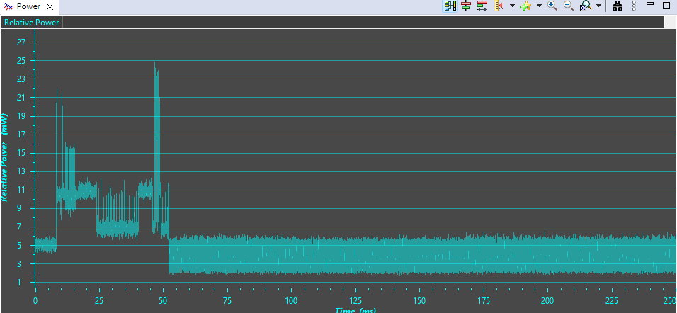

When powering the launchpad, at the beggining, I have seen that there is a high consumption during about 60 ms and it is about 10-12 mA. Why does it happen? It could be possible to minimize this time in which, I guess, the microcontroller is initializing?

    1. Do you have access to XDS110 - ET debugger probe from TI? If yes, could you please follow this guide: EnergyTrace User Guide to collect the current draw of the device from when it boots? You can start running energy trace and then reset the launchpad to see info from boot (press reset button). Please share a screenshot of the current draw (x and y axis are appreciated).
    2. Are you measuring the power consumption while running the program in debug mode? This will considerably increase the power consumption.
    3. What program are you running on the device? Is it an out of the box example, if yes, which one?

    I have used the XDS110 - ET debugger and followed the EnergyTrace guide as you suggested. I attach the image of the relative power when debugging the program (the voltage of the Energy Trace is 3.3V) and as you suggested the image of the current when running the energy trace and reseting the board.
    As for your second question, normally I measure the current consumption out of the debug mode by using the oscilloscope.
    By the way, I am using the basic_ble example from: SimpleLink Low Power F3 SDK (8.10.01.02)/Examples/Develompent Tools/CC2340R5 LaunchPad/BLE5-Stack/basic_ble. I have changed some parameters, I am using it only as a broadcaster and have changed the primary phy interval to 1000 ms (both minimum and maximum).
    As you can see when pressing the reset the current consumption has the same form as in the debug mode. I guess this current consumption is for just starting the micro, correct me if I am wrong. It could be possible to reduce the time this happens or to reduce the consumption? Both would be even better.

  • Hello Eñaut,
    Could we please try the following:
    1. Disable the UART display (see this guide for power consumption optimization in general): this might be consuming the 20 ms in between the system boot-up and the first advertising (from around 20 msto 40 ms) .
    2. The section of the reset event (from around 40 msto 55 ms) is actually the first advertisement.
    I would also suggest to compare the reset energy profile while using the empty project (found inside the driver examples from the SDK) to confirm the extra power consumption is coming from the application (BLE related in the basic_ble case).

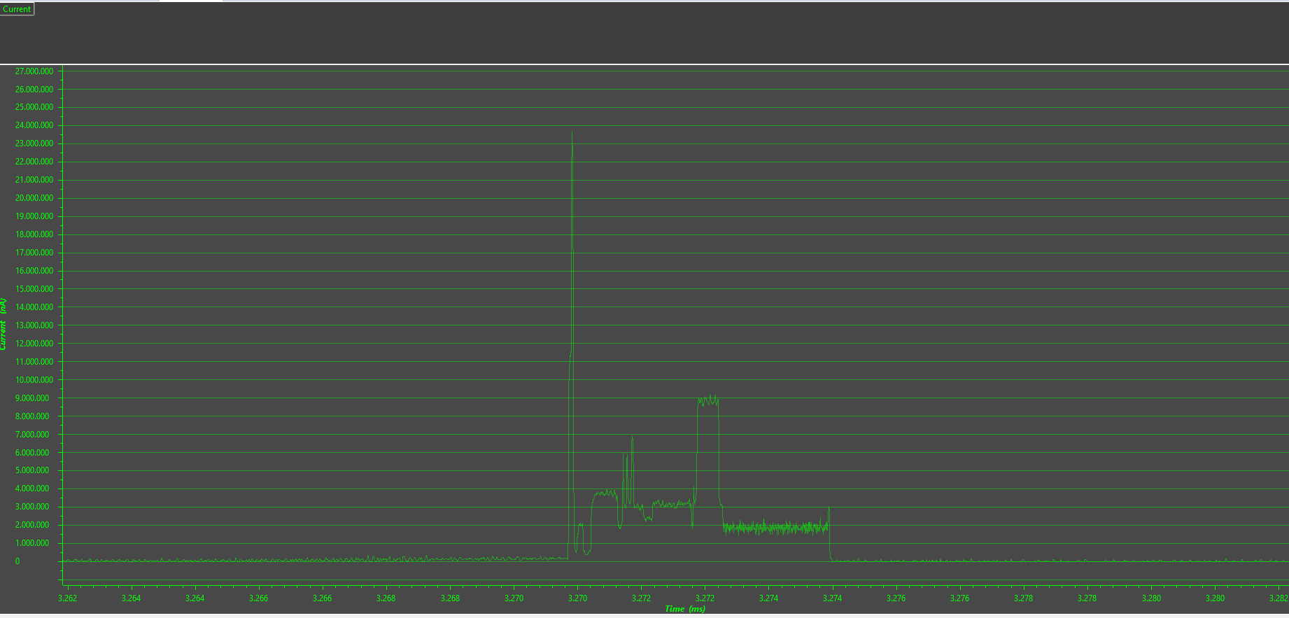

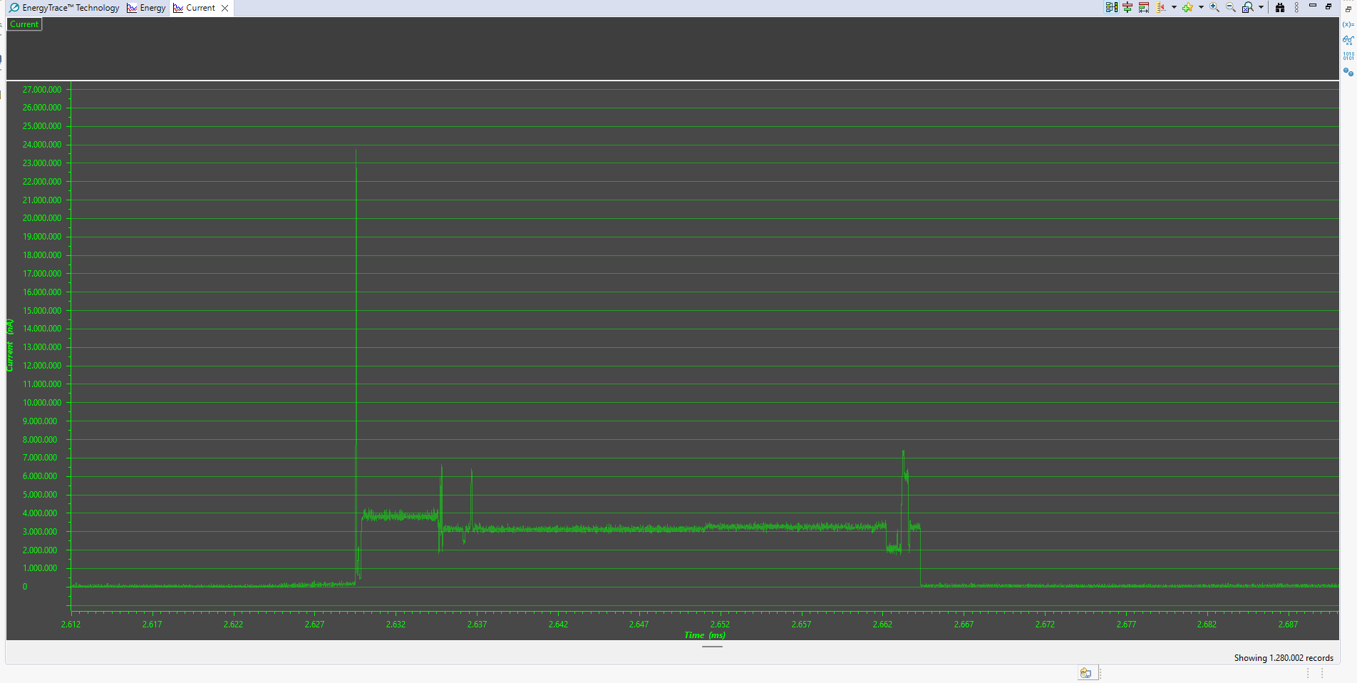

  • Hello David,
    I have disabled the UART display and it gets way shorter, I attach you the image. However the consumption is way to large for the application I am using it for. I have also loaded an empty project and it is much shorter, I attach you also the image so you can compare.
    The first one is about 35ms while the empty one is about 6ms. Are there any other option to reduce the current consumption during the boot? Having longer boot times with lower current consumption could fit with my power budget.

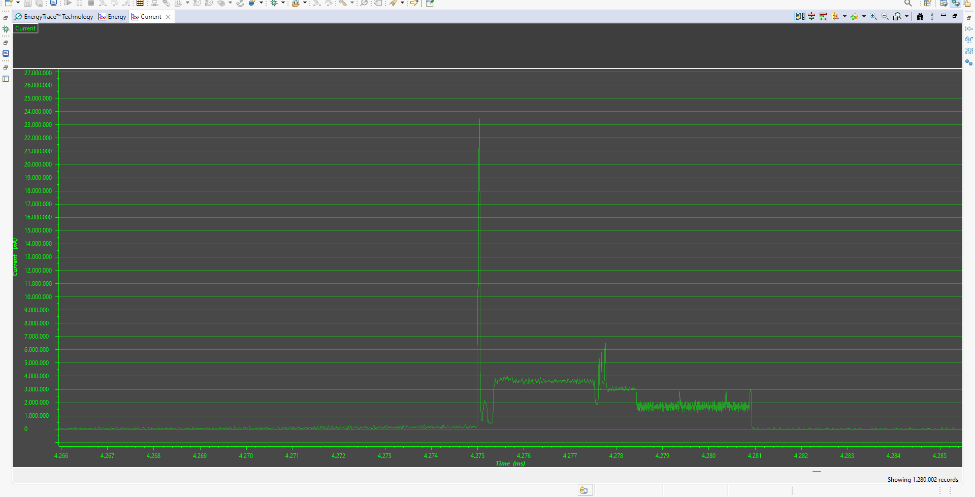

    Searching for another alternative, we have found another example project called rfPacketTx, which is in SimpleLink Low Power F3 SDK (8.10.01.02)/Examples/Develompent Tools/CC2340R5 LaunchPad/TI Propietary RF/rfPacketTx. It has an option to not use RTOS and it seems to boot more quicly, I attach you the image too. However, I am not sure of what it does and if it is necessary to use RTOS for my application.

  • Hi Eñaut,
    I have been reading about it and testing it and I think it would be a potential solution. I have made also tests using the one with RTOS and the one without and the consumption of the program without RTOS is slightly lower so it fits better for my application. But I am not sure if it works like a beacon or not, as I have seen that there is a syncword, does it mean that the receiving launcpad has to connect to the transmitting one? It would be possible to make a beacon with the PropRF?
    Please see this post: https://e2e.ti.com/support/wireless-connectivity/bluetooth-group/bluetooth/f/bluetooth-forum/1301556/cc2340r5-building-equivalent-of-tida00759-ble-pir-sensor
    If you need more details about the current spike during device boot (seen as ~23mA in the ET shots), I recommend to submit a separate post.
    Note that for RTOS, the initial setup time at ~3.8mA is a one time cost after device boot. If you are constantly re-booting, then I agree the noRTOS one makes sense. Otherwise, the RTOS one may provide better application development flow. Of course this all depends on what your application needs.
