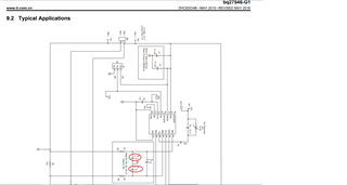

    I have taken a look at the schematic you have provided, and is there a reason for using the C3 and C6 capacitors? Additionally, since you have ENAB pulled down to ground, the gauge will not be able to ever enter shutdown mode. If you wish to use the shutdown power mode, then you should not permanently pull down ENAB.

      The reason for C5 C6 is to refer to the schematic diagram of BQ27546. Is it OK to paste C5 C6 capacitor.

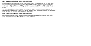

    If SHIP mode is required, I will leave the ENAB foot unconnected (vacant), and I will only enter and wake up SHIP mode through instructions 0X0015 and 0x0016.  Is this OK?  Thank you

    For the bq27z746 device I would recommend removing these capacitors as these are not recommended in the reference schematics for the BQ27z746.  Additionally, I would not leave ENAB floating. Instead it is recommended to connect ENAB to a GPIO to retain the full functionality.

    There is no GPIO output PIN for this project, may I ask if I do not connect the ENAB (vacant), is there any problem? Or do you have any better suggestions?

    I have seen people permanently pull down ENAB, but when you do this you forfeit the ability for the gauge to enter shutdown mode. This is why I suggested to connect ENAB to a GPIO for full functionality. I recommend referring to the enter and exit conditions for the power modes to see what functionality you would be loosing by permanently pulling ENAB down.

    I understand.  I change ENAB to not pull to GND, and I plan to change ENAB to not connect (empty).  Is there any problem with this?  (Because there is no extra GPIO PIN to connect) Thank you

    It is not recommended to leave the ENAB pin floating. If you cannot connect the ENAB pin to a GPIO or a push button, then you can permanently pull this pin down, but you will lose the ability for the gauge to enter shutdown mode.
