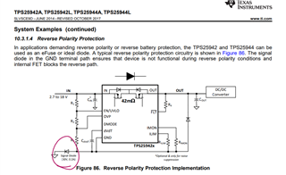

TPS25948: TPS259480AYWP Reverse Protection Issue
Part Number: TPS25948
In the component selection tool, it is stated that the TPS25948 series e-Fuse provides reverse connection protection. But there is no explanation about reverse connection protection in the datasheet.
In the datasheet revision history section, there is a statement like this;
I used TPS259480 for reverse voltage protection on a board I designed 6 months ago. Can we say that this feature does not exist according to the last revision records?
