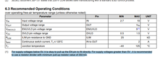

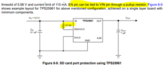

    To understand a minimum component count implementation, does TI advise against connecting EN/UVLO directly to VIN, even in applications below 5V? The TPS25961 datasheet shows an implementation for 3.3V and low current (copied below) that uses a 47k resistor pullup rather than a direct connection. Will a direct connection just increase pin leakage of is there any more significant reason to avoid?
  • Hi Chris,
    For this device EN can be pulled up directly to the Vin for supply less than 5V.
    Arush
