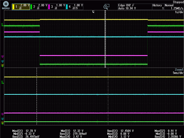

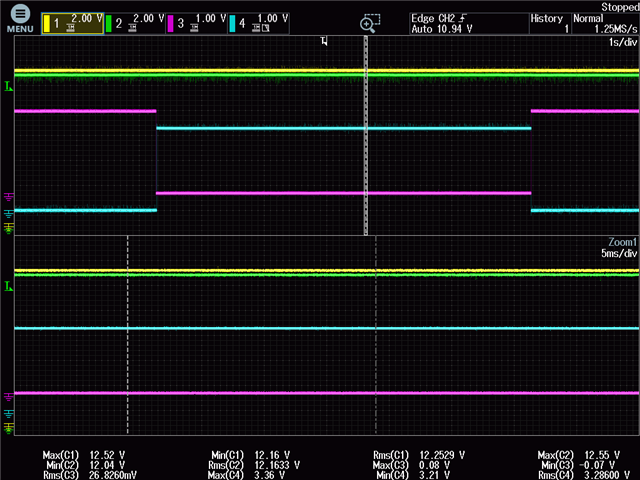

My customer is doing a eFuse box for NIO. And now they are testing TPS1H000-Q1 short to battery function but found some issue. 20k resistor has been added as pull-up from VIN to VOUT.
  • Vout is shorten to 12V bat: programmed flip IN every 5 seconds.
CH1:vin  CH2:vout CH3:IN  CH4:fault
  • Normal working :programmed flip IN every 5 seconds.
Please help to share how to recognize short to battery fault.
