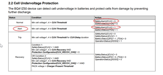

    Pin 5 is defined as ALERT pin by default. If any ALERT occurs under the Safety Alert register, it should set. And it should clear when Alert Clears. This should be all handled by firmware.
    Alert pin is configured as push_pull pin and ACTIVE_HI by default.
    How do you configure which conditions will/will not drive this pin low?
    When protections are enabled, it should trigger Alert for each protection by default. For instance, assuming CUV event occurs, the device will trigger an Alert when cell voltage is less than the defined CUV threshold. At this point, the ALERT pin should go hi. It should clear when Safety Alert clears.
