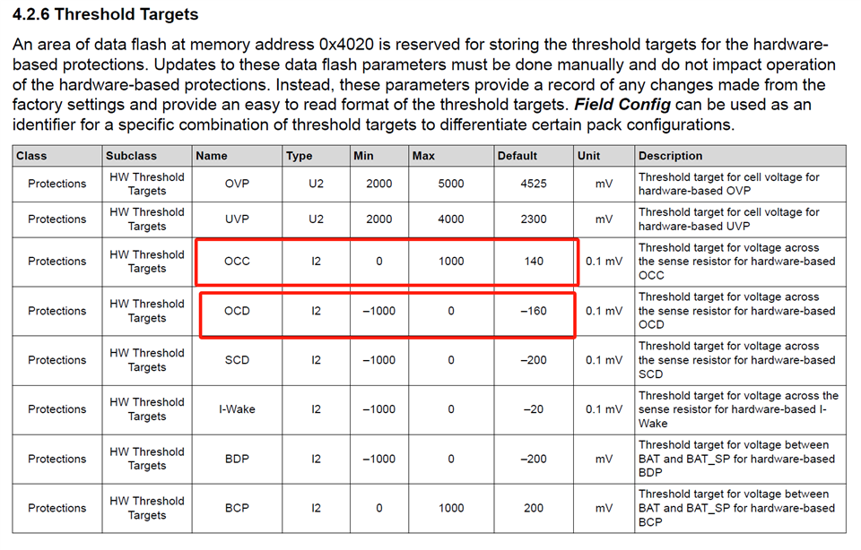

Hi ,
Could you please explain the difference between OCC and OCD in the two pictures below, and what they mean?
