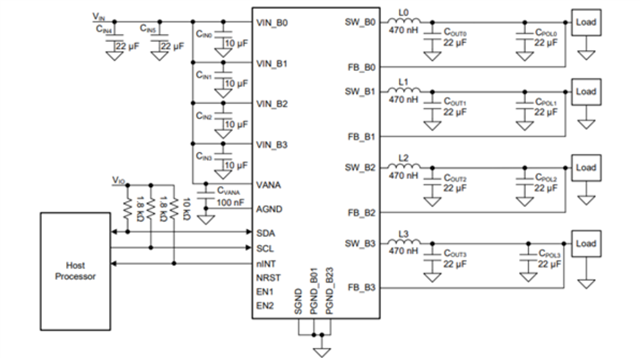

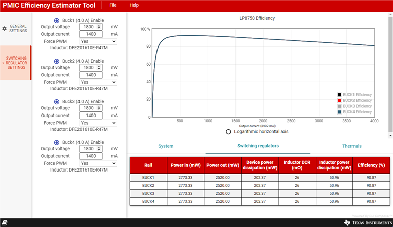

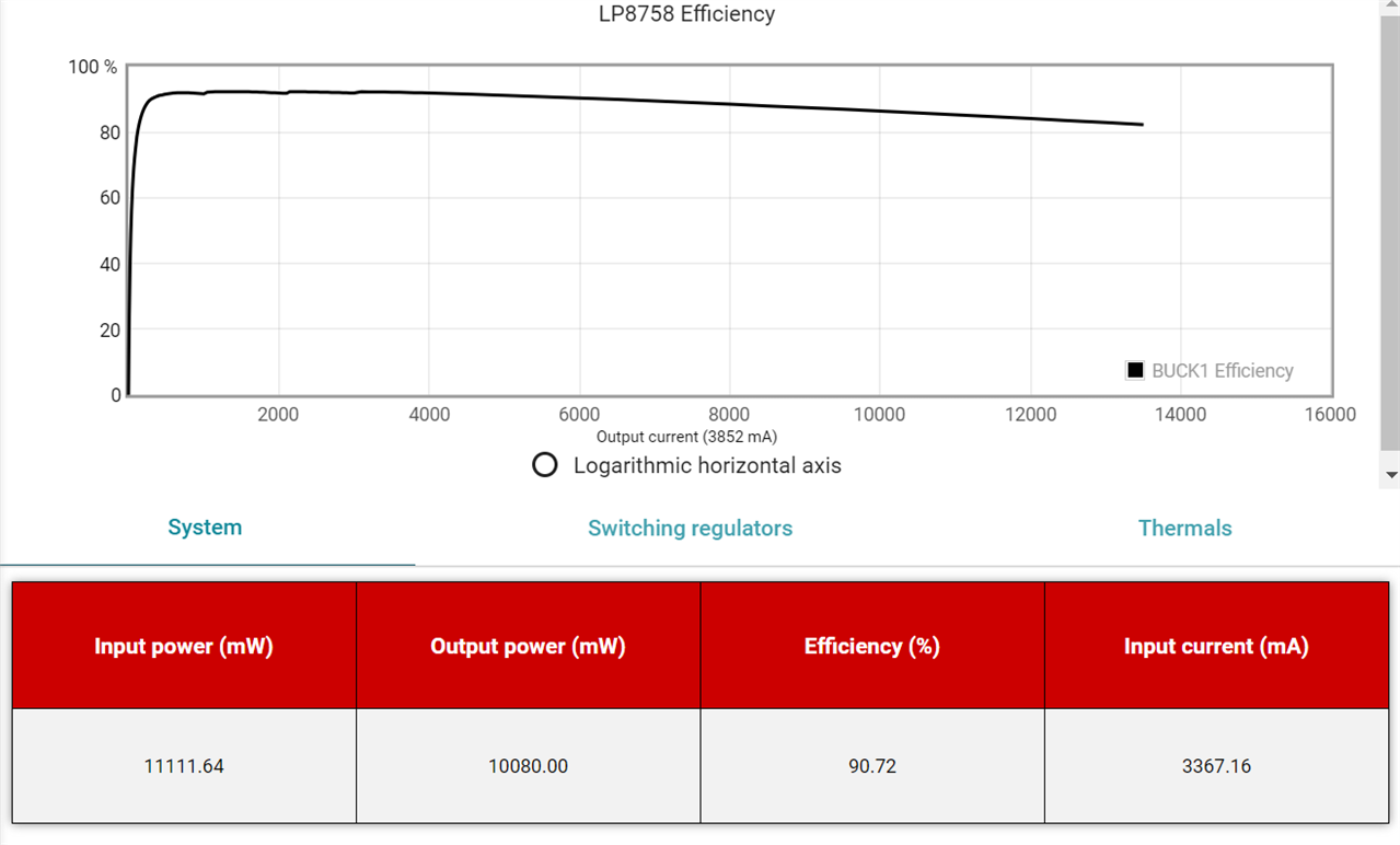

Is this efficiency curve for single channel and each phase can output 4A maximum current?

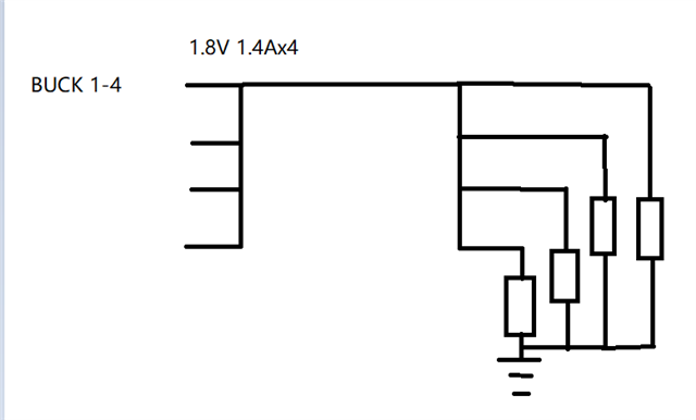

Besides, Customer use LP8758 to power 4 load with 3.3V input and 1.8V output, each load needs 1.4A current, the load can be parallel.
What is the efficiency way to power the load?
