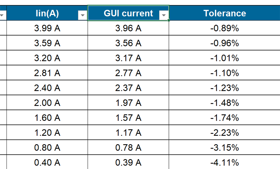

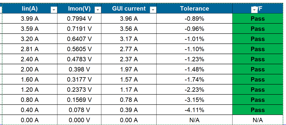

I would like to inquire about the Imon question related to TPS259824. Why the Imon report from the TPS259824 is inaccurate at low currents?
We currently have a case using the UCD9090ARGZR+TPS259824 solution.
The Imon pin of TPS259824 is connected to a 820 ohm res to GND and also connected to the MON pin of UCD9090ARGZR
We have found that the error in Imon increase gradually when the current is less than 1.5A.
Please refer to schematic and Imon report test table below.
