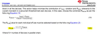

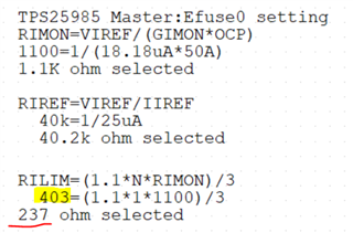

Hi TI expert,
For TPS25985*1 design, I want to caluate the RILIM value, but the equation (20)  and  TPS25985 cal-tool show the difference value? (403 ohm & 237 ohm)
Pelase let me know which value is correct setting for RILIM, thanks!
In my design, TPS25985*1, not stackable, the Mode Pin should keep " Open" , right?
