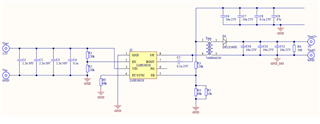

But my circuit configuration is below:
Vin 12Vdc (Fixed)
Primary Vo = 5.6V@0A. * I only need the isolation output of the secondary
Secondary Vo = 5.6V@0.5A.

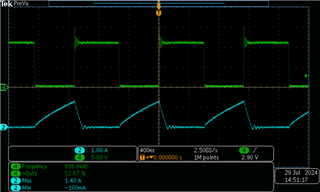

    1. What is happening when the output loads the current larger than 0.3A?
    Ans: The voltage drop is unstable, and the secondary output voltage drops significantly. Switch frequeny and duty vary.
    CH1 Pri sw node, CH2 primary inductor current.
    CH1 primary sw node, CH2 inductor current.

    3. Can you provide your schematic?

    Thank you for providing the schematic and waveform. If i'm not mistaken, I believe CH2 is the output inductor current, right?

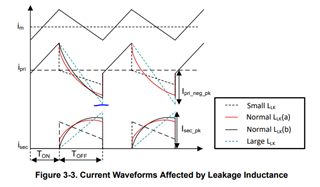

    I think the issue is related to your inductor and its lower leakage inductance. It is noted in a flybuck that if the leakage inductance is larger, than as the secondary current increases, the primary side current will also further decrease. It may get to a point where you may be hitting negative current limit, which terminates the LS pulse and causes your output to fall out of regulation.
    I think there are two solutions:
    1) Is it possible to find another inductor that has lower leakage inductance but around the same designed value?
    2) Can you try switching to the LMR38025 FPWM variant and see if that helps fix the issue since it has a lower negative current limit. I would probe the primary side inductor current.
