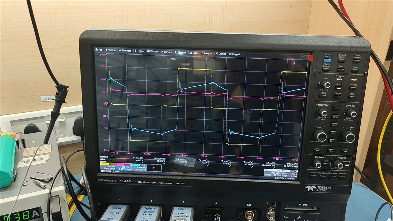

The voltage ring at transformer primary voltage is disappeared with reducing fixed delays.
FYI, TURNS RATIO : 27, Lmag: 8mH primary , Llkg :22uH
1. Vin : 600V, higher load currents , 20A and above
Yellow: primary transformer voltage
Blue : transformer primary current
2. At lower voltages , for example at Vin :400V, 450V,  load current:15A,
the current waveform at freewheeling period is increasing in other direction. Is it alright? Any reason why ? Is it due to low load current or high turns ratio ( 27 ) or anything else ??

  • Hi.
    This is Normal case only
    During first one conduction via Mosfet for certain time Ramp up current,&n via Diodes at downslope time
    second case Phase shift is maximum and very short span allowing diodes to freewheel that why it seems
    Reason for this is Winding capacitance, stray capacitance of switches, diodes and leakage inductance
    Anyhow its good to proceed with your testing,maybe snubber at secondary side required if secondary voltages having voltage overshoots

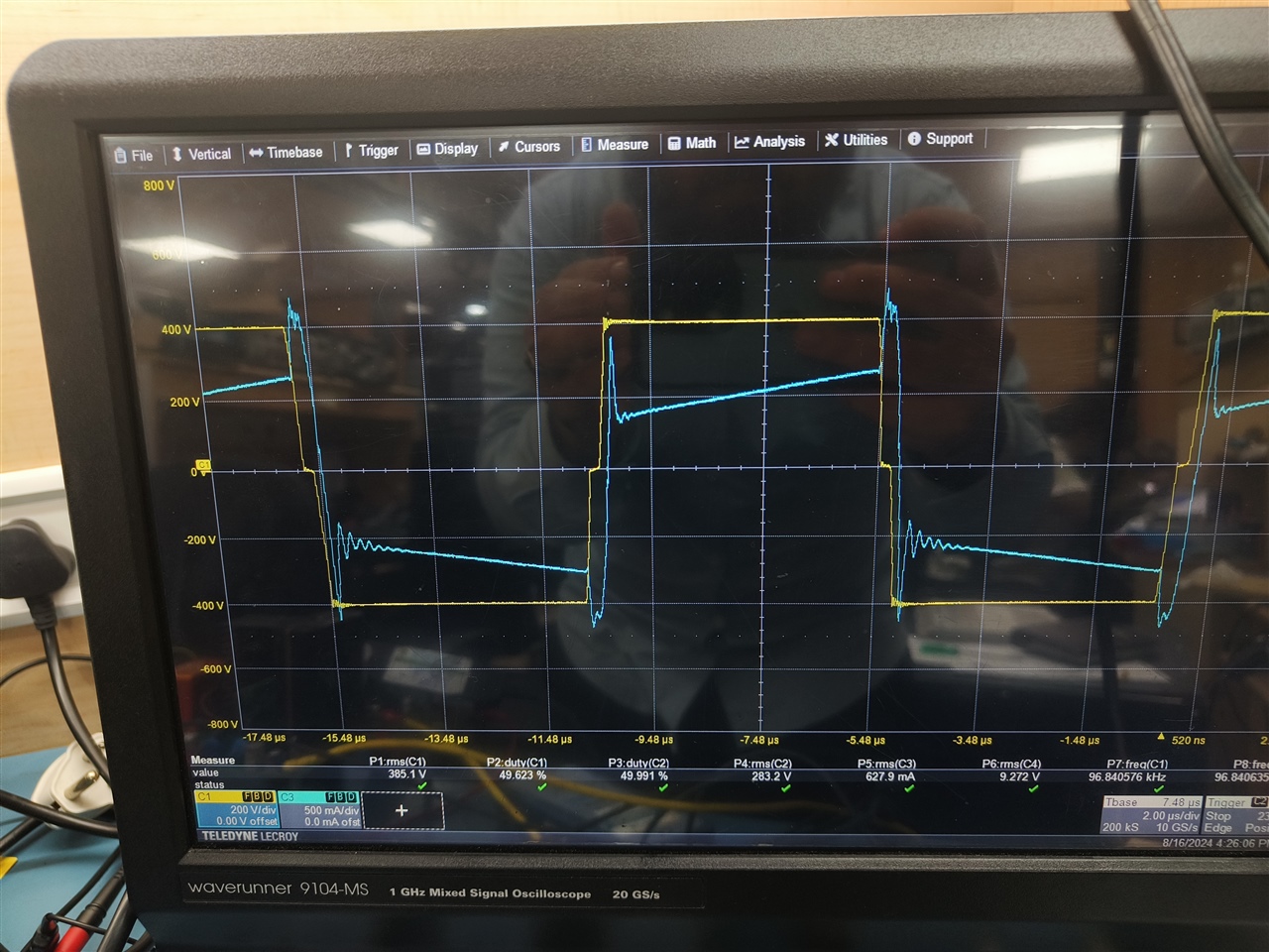

  • 1. What should be ideal winding capacitance ? Should it b less or more, what steps to take if it's more ?
    2. When you say phase shift is maximum , please explain this more in simpler terms for better understanding. Sic antiparallel diodes are placed. And MOSFETs are also SIC.
    MOSFET P/N: G3R160mt12d
    Diode p/n : gd02mps12e
    3. Ringing in the current waveform, how to reduce it ? Can we try some RC snubber across CT ? Or what is your suggestions.
    4. What values you suggest for SNUbber at secondary side . Please advise

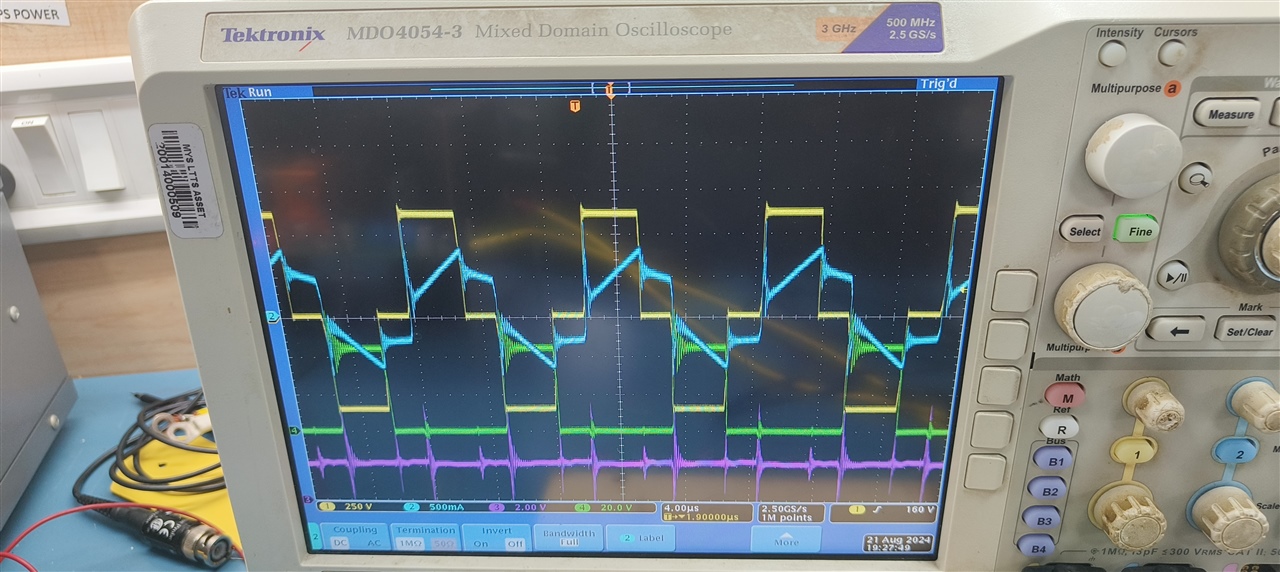

    I am not sure what you are seeing is parasitic capacitance.  At the end of your free wheeling before the current changes polarity there is a flat spot in the current waveform.   This flat spot is roughly 400 ns. This should not be the case you should still see the inductor down slope.  So why don't you see the inductor down slope?
    When you go to max duty cycle during the free wheeling period which is equal to 400 ns.  The current spikes and the inductor down slop is not seen.  This behavior should not be there.
    Are you doing something non traditional on the output of your design?  Could you share the schematic for review?

    When your design goes into freewheeling from this maximum duty cycle the transformer current should decrease with inductor current.  In you waveform it jumps up with a greater magnitude then it went into free wheeling.  This should not happen.   It is almost as if one of your SRs is shorting out the output inductor.
    You might want to double check how your output transformer windings are connected to the output filter.

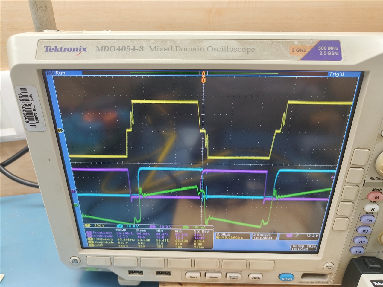

  • Hello Mike,
    1. What I noticed about that jump in current is, when I run secondary FETs in diode mode, that Jump is not present. When I turn the FETs ON, only at that time that jump is present.
    When gate signals are OFF
    Blue: primary current
    When gate signals are ON
    2.Additionally, When current changes direction, The rise in current, we are seeing noise / ringing at gate signals of synchronous FETs. Your comments and advise
    3. Can Synchronous FETs overlap for some duration? As een in my case ?
    4. Another thing is ringing in primary current waveforms, how to reduce it?
    5. Secondary side FETs have ringing across drain to source during switching, though RCD clamp is present. How to mitigate??
    > The transformer primary current does not look correct during the freewheeling cycle when the transformer current is negative.  It should look like the transformer current when the current is positive.  There might be something wrong in the way your output rectifiers are connected in your design.  You should double check this.
    >Not sure what the below waveform is.  Can you double check this?
    >Yes during the freewheeling period both FETs are on.
    >Your transformer primary current waveforms do not look correct.  I believe that there is something not connected correctly in your power stage.  I would double check it against application note slua560.
    https://www.ti.com/lit/pdf/slua560
    > I would start by figuring out why the primary transformer current is not correct.  Once you have figured out what is causing that issue you can move on and try to fix the ringing if it is still present.

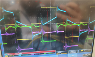

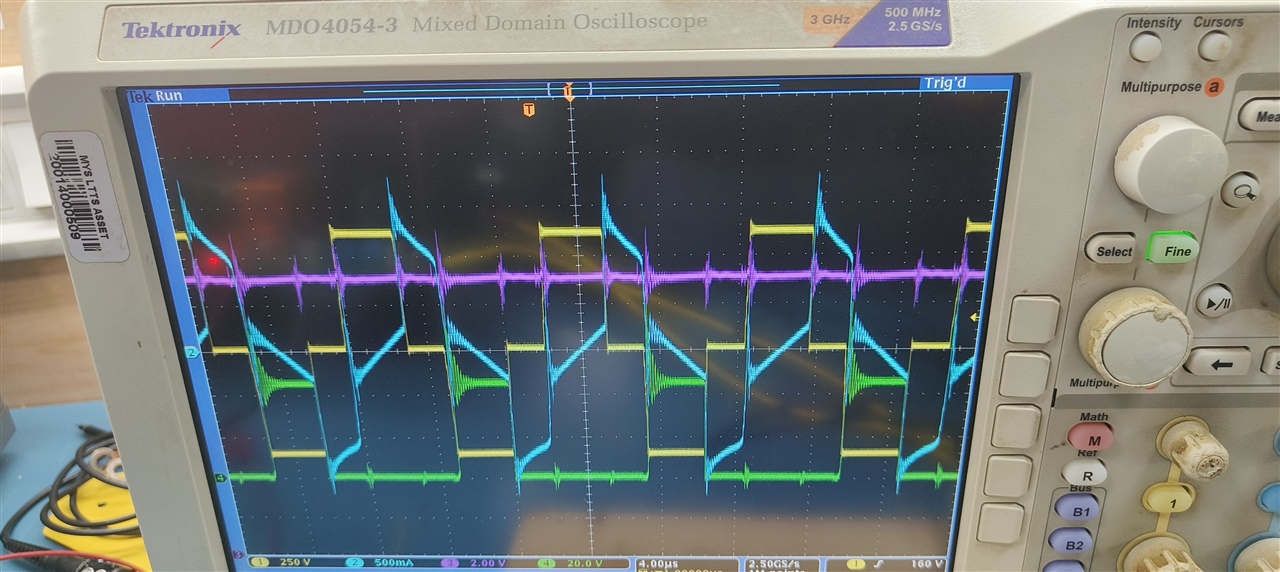

  • Hello Mike, below is transformer waveforms.
    1. Could you explain is this related to delays ? And what can be done to mitigate it ? Reduce delay??
    2. Additionally how to avoid leading edge current spike ? It increases with increase in voltage.

    The spikes are actually the resonant ring between the switch node capacitance and your shim inductor (Ls), leakage inductance Llk and switch node capacitance (Csw).
    Your are correct that his to do with your delays TABSET and TCDSET.  They are are to long.  You need to set the delays to 1/4 the resonant frequency please note the equation is below for setting the initial delay.
    TABSET = TCDSET = 1/(4*(*2*3.14*(Csw*(Ls+Llk)^0.5))
    I also drew a picture where this delay should be set. Your delay is just to long.
