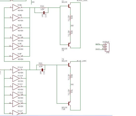

I Need MOSFET Circuit for the Following Ckt
ie i need to replace the BD139 Transistor by TI MOSFET.
The output is torridal transformer.
i need help to which TI Parts suitable for this?
TI's MOSFET portfolio only goes to Vds of 30V, so we do not have an BD139 equivalent.
Sorry,
Richard.
