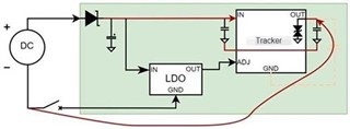

1) When DC supply's GND is disconnected (hot-swap), there will be a negative overshoot voltage at IN pin of 4255, which will be coupled to the OUT pin through input capacitor and output capacitor. And there will be a microsecond negative voltage at OUT pin (about -10V to GND). Will this negative voltage damage the device?

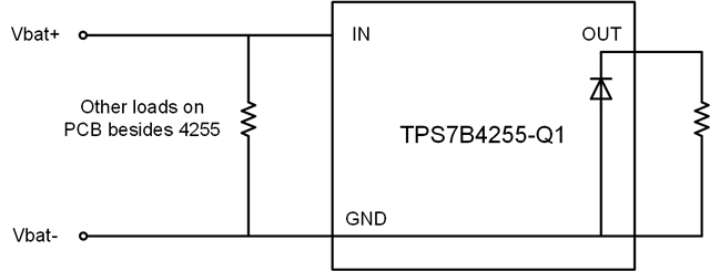

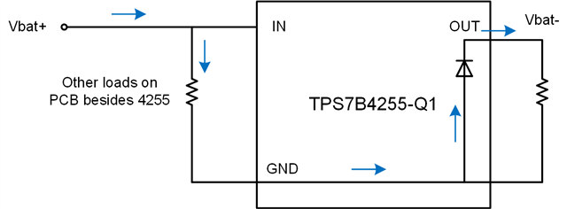

    2. DC supply is voltage of battery, the range is within -40 to 40V. But there is another concern: when the DC supply is connected normally to the board, the circuit is like pic shown below. I made the other loads besides 4255 equivalent to a resistor.
    When the cathode of DC supply is disconnected from the GND and connected to the OUT pin, there is a current loop from Vbat+ to Vbat-, when means the diode of OUT pin will carry the current from other loads on the board. According to customer, the current is about hundreds of mA, less than 1A.
    Can the diode of TPS7B4255-Q1 carry such current and not be damaged? (last for 60s)

  • This is what I got from the design team

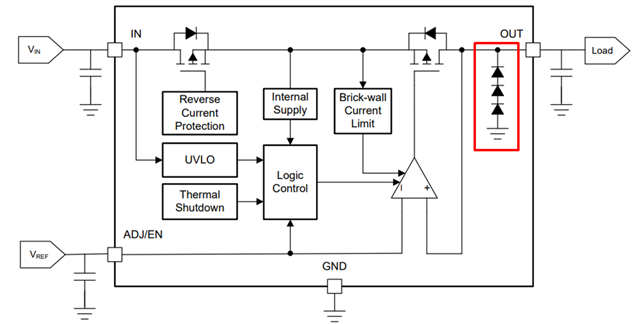

    "Knowing the requirement, I would say we can’t support >100uA current when VOUT is clamped to negative.
    It was not asked from definition to support current, however because of the -ve clamp that was designed based out of Zener, current path from ground is limited by the resistor depending on the VOUT(-ve) value.
    Other path from GGNMOS cant support DC current as this cell is meant for the ESD path."
