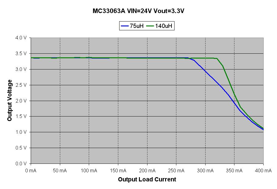

    I built a test circuit using the MC33063A, but I did not have a 100uH inductor readily available so I recorded data with 75uH and 140uH. Attached is a load regulation chart.
    The MC33063A did not overheat. It felt  warm to a firm finger press at full load.
    The main difference between my components and yours was my inductor had a closed loop core (1/2 inch outside diameter). I have not used a small RF chokes with the MC33063A before. However, I do not see why this would make a huge difference in MC33063A temperature.
    Can you measure the voltage on the Rcl resistor and CT pin voltage, there may be a clue to determine problem.
