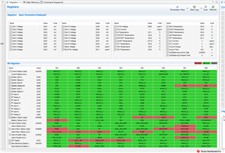

Attached is a screenshot of my current configuration in bqstudio, which might provide more clues.

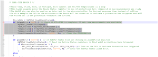

    I don't want the ADSCAN bit to trigger only once. My microcontroller detects a rising edge on the alert pin, reads the voltage, current, and temperature information, and then uses the code:
    c
    DirectCommands(AlarmStatus, 0x0020, W); // Clear the ADSCAN bit to make the alert pin go low
    After the measurement loop is completed, ADSCAN continues to trigger, the microcontroller reads the information and clears ADSCAN. This process repeats continuously.

    Thank you for clarifying. From the code you are sharing now, it looks like you are clearing the incorrect Alarm Status bit for ADSCAN.
    bqStudio will also tell you which Alarm Status is high.
    Can you try changing that and seeing if that resolves your issue?

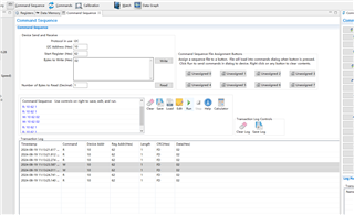

  • Hello Alexis_H,
    Oh, I'm very sorry, there was a typo in my previous messages. The command I actually used is: DirectCommands(AlarmStatus, 0x0002, 'W');. It's like this in my code, and I also use 0x0002 with the bqstudio software to clear it, as shown in the image:
    Darluu

  • Hello Darluu,
    Thank you for your patience. After testing the command in the lab with your current configuration, I found no issues other than what you typed in the ‘Command Sequence’. You wrote it to the correct register, however, you need to write all the bits in. In Bytes to Write (Hex), you need to write ’02 00’, instead of just ‘02’.
    Alexis
  • Hello Alexis_H,
    Thank you for your reply. Do you mean that I need to write 02 00 (hex) in the 'Command Sequence' of the BQStudio software?
    However, could you explain why this is necessary? Because I observed that the Alarm Status value is 0x0002, and based on my understanding, I should write 0002. I'm very much looking forward to your explanation.
    Additionally, in my microcontroller code, if I want to clear the ADSCAN alarm using DirectCommands(AlarmStatus, value, 'W');, what should the value be?
    Darluu
  • Hello Darluu,
    That is correct.
    That is because the device stores values in little endian byte order.
    The value you had previously should be correct. DirectCommands(AlarmStatus, 0x0002, 'W');
