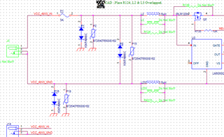

We are using LM74800QDRRRQ1 for our ORING section.
Kindly review the design and share your comments, if any.

Hi Aditi,
I can access the schematic now. The schematic looks fine connection wise.
What is the input power source? Do you expect any transients? This is to know the need of any TVS.

Hi Shiven,
Thanks for your feedback.
We are using POE type-4 (TPS2373-4RGW) as primary input source and 48V DC input jack connector as secondary input source.
We are using protection circuit for transients near RJ45 Jack-
for input connector side is as follow-
Also, I am attaching POE section, you can go through it for bettter understanding.

Hi Aditi,
I am not aware of the transients for POE type 4. Can you help me understand the max voltage at the input? Or just make sure voltage does not go higher than 70V after the clamping circuit.
