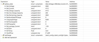

  • Hello Team,
     My fuel gauge will be reading the Design Capacity() and Current() values as expected. But in between some errors will be read I dont know why exactly.
    We probed the Sense resistors (SRN,SRP) and also current spike cannot be seen on Oscilloscope. But can be seen in Software.
    I am reading the Current() and DesignCapacity() registers every 1 seconds. But still we are observing the errors being read.
    1st image normal reading
    2nd Image Errors being read
    This error is random.
    Kindly let me know what is causing this error being read. Because we cant see any spike in hardware which we are probing using Oscilloscope when it reaches 4112 reading.
    Thank you
    Could be related to noise in your system.
    Are you seeing this issue on the EVM as well?
    Diego
  • Hello Diego,
    Sorry to say that we don't have EVM with us.
    Recreating this issue with EVM is not possible.
    Noise should be visible in Oscilloscope as well, right?
    But we cant see any difference in the Oscilloscope readings.
    This readings are directly read from Fuel gauge registers.
    There is no dependency or configurations for Read only registers right?
    Whatever value it is reading it should reflect.
    But my question is what exactly causing this issue.
    Noise means it should read other values also not only 4112. But the error value 4112 will only be read randomly.
    The readings will either be correct or 4112. No other noise value can be read
    This is making me think more now. How come the same error readings can be seen in two different registers.
    My other question is, we are setting Design Capacity value to 10000mAh in the beginning.
    But how come the error reading 4112 can be read at random intervals in Design Capacity() register readings.
    If you are reading Current() and Design Capacity() every one second, 2 out of 10 times it would read the value 4112 either in Current() or in Design Capacity() but other 8 times it will be normal like Current() be at -128mA and Design Capacity() be 10000mAh.
    Please let me know if I am missing anything
    Thank you

    uint8_t DEV_NUM[2]= {0x01,0x00};
    uint8_t FW_VRN[2] = {0x02,0x00};
    uint8_t BAT_STATUS[2] = {0x0A,0x0B};
    uint8_t VOLT_STATUS[2] = {0x08,0x09};
    uint8_t Read_addr1[2] = {0x3E,0x3F};
    uint8_t Read_addr2[2] = {0x40,0x41};
    uint8_t SS_BAT_CAP[2] = {0x27,0x10};
    uint8_t SS_DES_CAP[2] = {0x27,0x10};
    uint8_t FULL_CHRG_CPCTY[2] = {0x93,0x47};
    uint8_t DESIGN_CPCTY[2] = {0x93,0x49};
    uint16_t LRN_DSCHRGE_BRD_VAL =  0x0032;
    //uint16_t LRN_MIN_TEMP_VAL = 0x0064;
    //uint16_t LRN_MAX_TEMP_VAL = 0x0190;
    uint16_t EOS_CONFIGURATION_VAL = 0x0000;
    uint16_t DESIGN_CPCTY_1 = 0x9349;
    uint16_t DES_VALUE  = 0x2710;
    STAT_BAT battery_state =
             .BLTChargeSet = 0,
             .BLTDischargeSet = 0,
             .BLTSOH = 0,
             .BLTTemp = 0,
             .Bat_Current = 0,
             .Bat_Design_Capacity = 0,
             .Bat_Full_Charge_Capacity = 0,
             .Bat_Remaining_Capacity = 0,
             .Bat_Voltage = 0,
             .ChargingVoltage = 0,
             .Bat_average_Current = 0,
             .RelativeStateOfCharge = 0,
             .DevIDTrue = false
    void bq34210_fuel_init(void);
    void fuel_gauge_manager(void)
        switch(fuel_mode.fuel_state)
            case FUEL_NONE:
                fuel_mode.fuel_state = FUEL_INIT;
                battery_state.DevIDTrue = false;
                break;
            case FUEL_INIT:
                bq34210_fuel_init();
                fuel_mode.fuel_state = FUEL_READ;
                break;
            case FUEL_READ:
                fuelGauge_Start();
                break;
            case FUEL_WRITE:
                break;
            default:
                fuel_mode.fuel_state = FUEL_NONE;
    uint8_t bq34210_fuel_gauge_write(uint8_t regAdr,uint16_t regData,uint32_t base,uint8_t NoBytes)
        _I2C_Handle fuel_gauge;
        uint8_t uiBuffer[10];
        uint8_t Result = 0;
        uiBuffer[0] = regData;
        fuel_gauge.i2cbase = base;
        fuel_gauge.locAdr = regAdr;
        fuel_gauge.buf = &uiBuffer[0];
        fuel_gauge.bufLen = NoBytes;
        fuel_gauge.slaveAdr = BQ34210_ADDRESS;
        Result = i2c_writeFG(&fuel_gauge);
        return Result;
    uint16_t bq34210_fuel_gauge_read(uint8_t regAdr,uint8_t *regData, uint32_t base, uint8_t noBytes)
        _I2C_Handle fuel_handle;
        uint32_t Result = 0;
        fuel_handle.i2cbase = base;
        fuel_handle.locAdr = regAdr;
        fuel_handle.buf = regData;
        fuel_handle.bufLen = noBytes;
        fuel_handle.slaveAdr = BQ34210_ADDRESS;
        i2c_read(&fuel_handle);
        int i;
        for(i = 0; i < noBytes; i++)
            regData[i] = fuel_handle.buf[i];
        return Result;
        port_control(GPIO_PORTB_BASE, SOC_LRN_LD_EN, 0);
        port_control(GPIO_PORTC_BASE, FG_ALERT_CTL, FG_ALERT_CTL);
        port_control(GPIO_PORTE_BASE, CHARGER_EN, 0);
        SysCtlDelay(100000);
        port_control(GPIO_PORTC_BASE, FG_ALERT_CTL, 0);
        SysCtlDelay(2500000);
    //    port_control(GPIO_PORTE_BASE, CHARGER_EN, CHARGER_EN);
        uint16_t eosLearnStatRead;
        SysCtlDelay(20000);
        update_config(OPRTN_CONFG_A_REG, OPRTN_CONFG_A_VAL);
        SysCtlDelay(20000);
        SysCtlDelay(4000000);
        resetFuelGuage();
        SysCtlDelay(1000000);
    #ifdef CHARGE
        update_config(EOS_CONFIGURATION_REG, EOS_CONFIGURATION_VAL);
        SysCtlDelay(20000);
    #elif DISCHARGE
        EOS_CONFIGURATION_VAL = 0x0200;
        SysCtlDelay(20000);
    #else
    #endif
        update_config(DSG_DTCN_THRSHLD_REG, DSGG_DTCN_THRSHLD_VAL);
        SysCtlDelay(20000);
        update_config(DSG_RLX_TM_REG, DSG_RLX_TM_VAL);
        SysCtlDelay(20000);
        update_config(CHRG_DTCN_THRSHLD_REG, CHRG_DTCN_THRSHLD_VAL);
        SysCtlDelay(20000);
        update_config(CHRG_RLX_TM_REG, CHRG_RLX_TM_VAL);
        SysCtlDelay(20000);
        update_config(LRN_DSCHRGE_CRNT_REG, LRN_DSCHRGE_CRNT_VAL);
        SysCtlDelay(20000);
        update_config(LRN_DSCHRGE_BRD_REG, LRN_DSCHRGE_BRD_VAL);
        SysCtlDelay(20000);
        update_config(DESIGN_CPCTY_1, DES_VALUE);
        SysCtlDelay(20000);
    //    update_config(DESIGN_VOLT_REG, DESIGN_VOLT_VAL);
    //    SysCtlDelay(20000);
        update_config(GAUGING_CONF_REG, GAUGING_CONF_VAL);
        SysCtlDelay(20000);
        update_config(NEAR_FULL_REG, NEAR_FULL_VAL);
        SysCtlDelay(20000);
        update_config(QUIT_CUR_REG, QUIT_CUR_VAL);
        SysCtlDelay(20000);
    //    update_config(QUIT_RLX_TM_REG, QUIT_RLX_TM_VAL);
        SysCtlDelay(20000);
        update_config(OVRLD_CRNT_REG, OVRLD_CRNT_VAL);
        SysCtlDelay(20000);
        update_config(TAPER_CURRENT_REG, TAPER_CURRENT_VAL);
        SysCtlDelay(20000);
    //    update_config(AUTO_LEARN_TIME_REG, AUTO_LEARN_TIME_VAL);
    //    SysCtlDelay(2000000);
    //    update_config(SET_VOL_THRSHLD_REG_FD, SET_VOL_THRSHLD_VAL_FD);
    //    update_config(CLR_VOL_THRSHLD_REG_FD, CLR_VOL_THRSHLD_VAL_FD);
    //    update_config(SET_VOL_THRSHLD_REG_FC, SET_VOL_THRSHLD_VAL_FC);
    //    update_config(CLR_VOL_THRSHLD_REG_FC, CLR_VOL_THRSHLD_VAL_FC);
    //    update_config(SET_VOL_THRSHLD_REG_TD, SET_VOL_THRSHLD_VAL_TD);
    //    update_config(CLR_VOL_THRSHLD_REG_TD, CLR_VOL_THRSHLD_VAL_TD);
    //    update_config(SET_VOL_THRSHLD_REG_TC, SET_VOL_THRSHLD_VAL_TC);
    //    update_config(CLR_VOL_THRSHLD_REG_TC, CLR_VOL_THRSHLD_VAL_TC);
    void fuelGauge_Start(void)
        fullChargeCapacity();
        gaugeReadings();
        //    autoLearnTimeRead(AUTO_LEARN_TIME_REG);
        enterCalibration();
        SysCtlDelay(10000000);
        exitCalibration();
        LearningPhase();
    void batteryStatus(void)
        SysCtlDelay(FUEL_READ_DELAY);
        uint8_t batStat_HighByte,batStatLowByte;
        uint8_t regAdd[2];
        uint8_t devAdd = BAT_STATUS[0];
        bq34210_fuel_gauge_read(devAdd, regAdd, FUEL_I2C, 1);
        batStat_HighByte = regAdd[1];
        devAdd = BAT_STATUS[1];
        batStatLowByte = regAdd[0];
        fuelGauge.batteryStatus.highByte.HighByte = batStat_HighByte;
        fuelGauge.batteryStatus.lowByte.LowByte = batStatLowByte;
    void voltage(void)
        uint8_t regAdd[2];
        uint8_t devAdd = VOLT_STATUS[0];
        bq34210_fuel_gauge_read(devAdd, regAdd, FUEL_I2C, 2);
        battery_state.Bat_Voltage = (regAdd[1] << 8) | regAdd[0];
        devAdd = 0x30;
        battery_state.ChargingVoltage = (regAdd[1] << 8) | regAdd[0];
    void current(void)
        int8_t signNP;
        uint8_t regData[2];
        uint8_t devAdd;
        devAdd = 0x0C;
        uint16_t tempVal;
        bq34210_fuel_gauge_read(devAdd, regData, FUEL_I2C, 2);
        battery_state.Bat_Current = (regData[1] << 8) | regData[0];
    //    if(battery_state.Bat_Cur & 0x8000)
    //        signNP = -1;
    //    else
    //        signNP = 1;
    //    tempVal = battery_state.Bat_Cur;
    //    battery_state.Bat_Cur = twoScomplimant(tempVal);
        devAdd = 0x14;
        battery_state.Bat_average_Current = (regData[1] << 8) | regData[0];
    void averageTToEmpty(void)
        uint8_t regData[2];
        uint8_t devAdd;
        devAdd = 0x16;
        battery_state.BLTAverageTimeToEmpty = (regData[1] << 8) | regData[0];
    void devId_Read(void)
        uint16_t devId;
        uint8_t regAdd[4];
        uint8_t dummy = 0;
        uint16_t ret_value = 0;
        uint8_t devAdd = CONTROL_STATUS[0];
        uint8_t devData = DEV_NUM[0];
        SysCtlDelay(FUEL_GAUGE_INIT_DELAY);
        bq34210_fuel_gauge_write(devAdd,devData,FUEL_I2C,1);
        SysCtlDelay(DELAY_FUEL_GAUGE);
        devAdd = CONTROL_STATUS[1];
        devData = DEV_NUM[1];
        devAdd = Read_addr1[0];
        ret_value = bq34210_fuel_gauge_read(devAdd, regAdd, FUEL_I2C, 4);
        devId = regAdd[3] << 8;
        devId |= regAdd[2];
        while(devId != BQ34210_DEV_NUM)
        if(devId == BQ34210_DEV_NUM)
            battery_state.DevIDTrue = true;
    void fwVersionRead(void)
        uint16_t fwVer;
        uint8_t regAdd[4];
        uint8_t dummy = 0;
        uint8_t devData = FW_VRN[0];
        devData = FW_VRN[1];
        devAdd = 0x40;
        fwVer = regAdd[3] << 8;
        fwVer |= regAdd[2];
    //    while(fwVer != BQ34210_DEV_NUM)
    //    if(fwVer == BQ34210_DEV_NUM)
    //        battery_state.DevIDTrue = true;
    void autoLearnTimeRead(uint16_t regAddress)
        uint8_t readData[4];
        uint8_t regAdd[2];
        uint8_t regData[2];
        regAdd[1] = regAddress >> 8;
        regAdd[0] = regAddress & 0xFF;
        uint8_t OLD_MSB,NEW_MSB,OLD_LSB,NEW_LSB,OLD_CHCKSUM,NEW_CHCKSUM;
        uint8_t OLD_LEN,NEW_LEN;
        uint16_t temp;
        unsealAccess();
        enterConfigMode();
        do
            operationalStatus();
        }while(!fuelGauge.operationalStatus.highByte.bits.CFGUPDATE);
        uint8_t devAdd = 0x3E;
        uint8_t devData = regAdd[0];
        bq34210_fuel_gauge_write(devAdd, devData, FUEL_I2C, 1);
        devAdd = 0x3F;
        devData = regAdd[1];
        devAdd = 0x60;
        bq34210_fuel_gauge_read(devAdd, readData, FUEL_I2C, 1);
        OLD_CHCKSUM = readData[0];
        devAdd = 0x61;
        OLD_LEN = readData[0];
        devAdd = 0x3E;
        devAdd = 0x3F;
        devAdd = 0x40;
        OLD_MSB = readData[0];
        devAdd = 0x41;
        OLD_LSB = readData[0];
        Auto_Learn_Time = (OLD_MSB << 8) | OLD_LSB;
        exitConfigMode();
        do
        }while(fuelGauge.operationalStatus.highByte.bits.CFGUPDATE);
        sealAccess();
    void remainingCapacity(void)
        uint8_t HighByte,LowByte;
        uint8_t regAdd[2];
        uint8_t devAdd = 0x10;
        devAdd = 0x11;
        battery_state.Bat_Remaining_Capacity = (HighByte << 8) | LowByte;
    void fullChargeCapacity(void)
        uint8_t regAdd[2];
        uint8_t devAdd = 0x3C;
        devAdd = 0x3D;
        HighByte = regAdd[0];
        battery_state.Bat_Design_Capacity = (HighByte << 8) | LowByte;
        devAdd = 0x12;
        devAdd = 0x13;
        battery_state.Bat_Full_Charge_Capacity = (HighByte << 8) | LowByte;
    void relativeStateOfCharge(void)
        uint8_t regAdd[2];
        uint8_t devAdd = 0x2C;
        devAdd = 0x2D;
        battery_state.RelativeStateOfCharge = (HighByte << 8) | LowByte;
    void resetFuelGuage(void)
        uint8_t devAdd;
        uint8_t devData;
        uint8_t readData[2];
        uint16_t opStat;
        unsealAccess();
        enterConfigMode();
        do
            SysCtlDelay(10000);
            SysCtlDelay(10000);
        /* Resetting fuel gauge 0x0041 */
        devAdd = 0x3E;
        devData = 0x41;
        devAdd = 0x3F;
        devData = 0x00;
    //    /* Acumulated Reset 0x004B */
    //    devAdd = 0x00;
    //    devData = 0x4B;
    //    bq34210_fuel_gauge_write(devAdd,devData,FUEL_I2C,1);
    //    SysCtlDelay(FUEL_READ_DELAY);
    //    devAdd = 0x01;
    //    devData = 0x00;
        exitConfigMode();
        do
