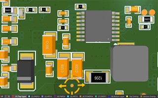

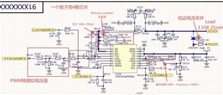

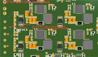

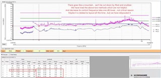

Hi Team,
My customer is testing the EMC of TPS92643-Q1(4pcs/board). Now, they can pass the CEC and RE test, but failed on CEV test. The test result is shown below.
Could you please help review and give some suggestions to improve it? Many thanks.
