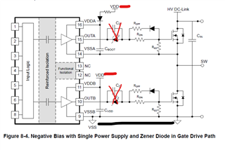

I need some clarification regarding single power supply example in figure 8.4, page 33 of the UCC21550 datasheet.
1) In the  single power supply configuration, VDD (12V Isolated power supply) is supplied both to VDDA and VDDB?
2) VSSA is connected to the  the Switch node (V_DS)?
3) The Negative of the VDD (GND) is connected to VSSB
4) The Negative of the VDD (GND) is the same GND as the Low side MOSFET?
5) The Cz and Vz components are not required in the circuit?
6) The ROFF values needs to be lower than RON resistor?

    1. Yes, a single supply is used to power both VDDA and VDDB.
      1. In the figure, a bootstrap is used for VDDA which allows for a single supply to be used.
    2. Correct, VSSA in the figure is connected to the switch node.
    3. Correct, the VSSB is connected to the ground of the secondary side.
    4. Correct, the channel B ground (VSSB) is connected to the LS MOSFET ground on the power stage.
    5. Cz and the Zener diode are not required in this circuit. These are there for setting a negative bias on VSSA.
    6. ROFF typically is set lower than RON to allow a higher sink current when turning off the MOSFET.

  • Also, on the application example in Figure 8.4, page 33 of the UCC21550
    6)How does the the zener diode Vz and the capacitor Cz generate a negative bias during turn off
    7) What are the values of the zener diode vz and the capacitor Cz?

    6.) After several cycles, the capacitor Cz develops a voltage across it that is clamped by the Zener reverse voltage. The result of this is the output waveforms being shifted down by the voltage charge in Cz. This negative shift adds margin to the threshold voltage to turn on the MOSFET.
    7.) The Zener diode should be selected to have the desired reverse voltage for the negative bias. The capacitor should be selected to be able to hold the charge from the switching cycles.

    1) What is the  recommended value for the capacitor Cz?
    ) Is the zener diode in this configuration 5.1V? i.e., in series with the gate drive signal
    Kind regards,
    Bright
  • Hi Bright,
    A 1uF capacitor should be sufficient.
    The Zener diode can be any value that you want to clamp the capacitor to. A 5.1V will work.
