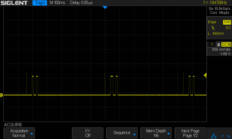

    If possible, can you please use a scope to observe the behavior of the TS1 pin of the device? If there is a pulsing of 1s intervals, the device is currently in normal mode. For reference, sleep mode will change this pulsing to 4s.

    TS1 pulses with about 2Hz:

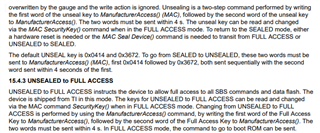

    If the gauge is unsealed during application, this would allow for the data flash memory to be altered, which could be leading to the issue being seen. Can you please go more into depth about why the gauge is being left unsealed?

    Yes, not sealing the device allows to alter the flash memory, but what mechanism can you think of? The BMS is inside the battery enclosure, and it is not reasonable to assume that a customer is doing this actively.
    Is it possible that the device 'sees' a command via I2C that causes this, for example through EMI?
    The gauge was left unsealed because we did not see a need for this, and that way we can easier diagnose field returns.
    We can of course add a SEAL command at the end of the test sequence, but I would want to first understand that this will likely solve this issue. At the moment I cannot spot the causal link.
  • Hi Frank,
    If the gauge is in an unsealed state, then I believe it is possible to change the seal keys, which would make sense for the situation above.

    The programming is done through custom code, is it possible that we do not adhere to the timing requirements when writing the data? We do make a 100ms pause after each call to ManufacturerBlockAccess (32 bytes of data). We reset the device multiple times in the process. Anything else that we need to consider (except sealing) that can improve the reliability?

    As long as the timing requirements for the SMBus specs are being met, I believe the programming should be fine. Is there any ESD preventative components attached to the communication lines of the device since they are left unconnected?

    When trying to unseal the device, has it been tried with the 0xFFFF keys to try and see if this was the value it was changed to along side meeting the 4s timing between sending each command?

    I had tried that, but am not sure about the timing that you mention. Can you please write down the sequence of commands and their timing, that I should try?

  • Hi Frank,
    I believe the description from the TRM below does a good job detailing this. I wanted to confirm that each word of the key for unseal and full access unseal are being sent within the 4s window of each other.
    Anthony
