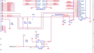

I am using a MIC2091 to provide power to an HDMI port. It is failing quite often and I would like to replace it with the TPS22948.  I have hot-wired a TPS22948 in my circuit and tested it. Plugging sinks and sources to it.  So far so good.  But I would like for the circuit reviewed as my customer wants to have a ferrite bead for EMI in the path.

    The schematic looks fine. Do you have any waveforms during the test which is resulting in the device failing. Hot plugging can cause high transients.

    Hot-plugging the output with 5V can result in transients, which can exceed the abs maximum of the device (6V). I know, you weren't able to capture the fault but you should be able to check the transients maximum. Also if you try to connect the plug faster, you should be able to get higher transients.
    Connecting some decoupling cap near the device out pin should help if it is these transients which is causing the fail.

    Not shown in the schematic (sorry!) is a RCLAMP0524PATCT TVS diode very close to the pin of the HDMI connector.  I would think that would help, if not eliminate the transients.  If I decide to use the TPS part, I can put some caps near the device.  What do you think about the TVS part?

    I don't think TVS part will help much as the abs maximum of the device is 6V and the clamping voltage of this device is 15V. On evaluation, if it is reducing the transients then that is good.
