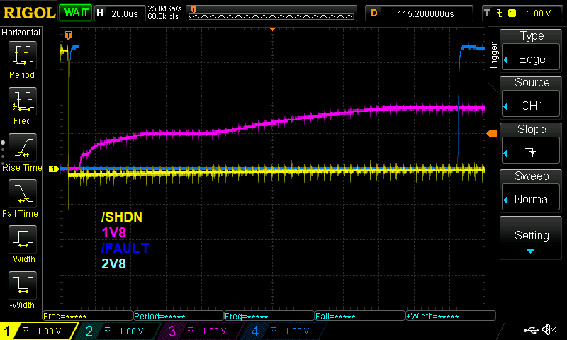

3V3 (always-on) feeds two LDOs, one for a 1.8V rail and another one for a 2.8V rail. 1.8V needs to start before 2.8V, so we cascaded them by having the /FAULT pin of the first LDO (1.8V) connected to the /SHDN pin of the second LDO (2.8V)
The first LDO (1.8V) is controlled with a software driven output connected to the /SHDN pin

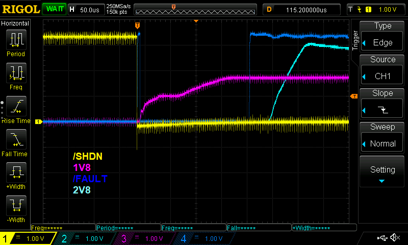

The circuit was validated with the Maxim chip and attached are the waveforms of a typical power-up sequence. You can see that the second LDO (2.8V) does not start before the first one (1.8V) enters regulation.

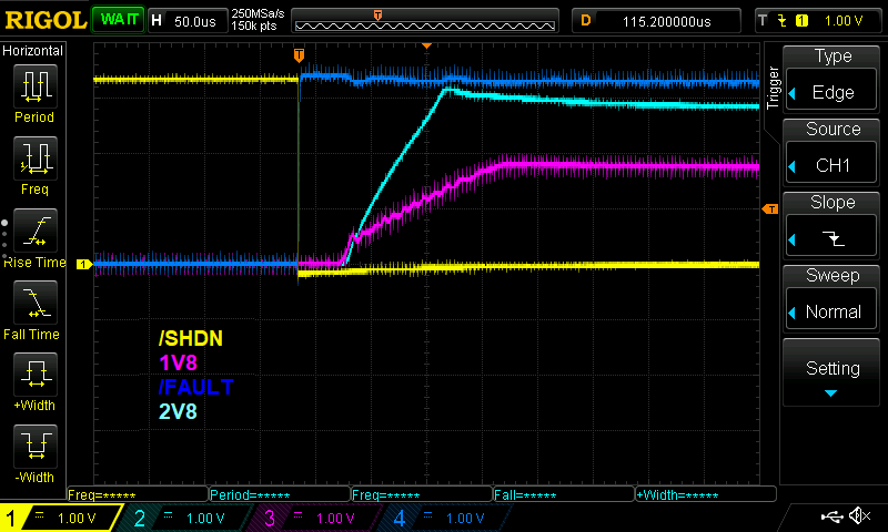

Now with the TI chip in place, we obtain a very different behaviour. Both LDO's power up at the same time. The /FAULT pin does not reflect the state of the 1.8V regulation.

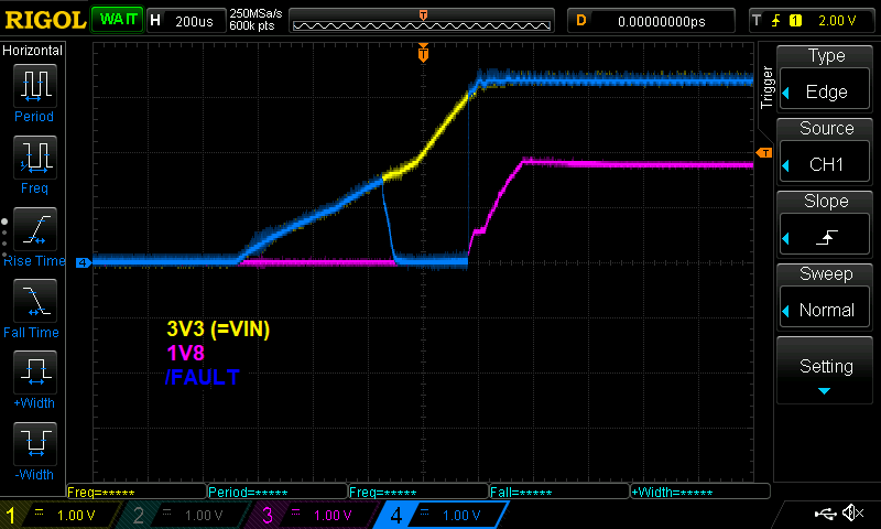

  • Hi Nick,
    Thanks again for your reply.
    As you suggested, I modified my setup to force the /SHDN pin high in order to look at the chip's behaviour when VIN first powers-up.
    Close-up (50us per div)
    This is quite different to figure 11. I note that ramping times in my setup are about 30 times faster (5 ms/div on figure 11, which is pretty slow).
    Both plots (TI's and mine) clearly show that the /FAULT pin is driven low as soon as VIN reaches about 1.5V, however in my case it is released (high) way before VO (1.8V) reaches regulation.
