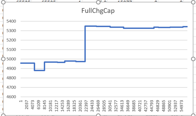

Dear Ti expert,
I am useing BQ40Z50 design one BMS, achieving learning cycle, the chemical ID is 7670
the first step discharging battery to empty, and relax for at least 5 hours, successful, update status 0x04
the second step charge battery to full, and then relax, update status change to 0x05
the third step discharge battery to empty and relax, update status change to 0x06
the accessory is cycleing data and gg.file3022.golden file.gg.csvlearningCycle20240817.log
