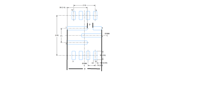

I am building footprint for the TI Part: TPS51386RJNR and not able to find X or Y dimension b/w pin number 1 & 8

The X and Y of Pin 8 is as same as Pin3~Pin6 and Pin9~Pin12. The X and Y of Pin 1 is as same as Pin2. I'm not sure which size you are talking about. If my understanding is wrong, you can take a screenshot and ask me the location of the specific size you are not sure about.

For placing PIN 1 or 3 in need airgap b/w pin 1&8 or End to End dimension. please refere attcahed screen short
For the length of A and B, customer can calculate from this figure:
A= 2*(0.6-0.5*0.25+0.5*1.5)=2*1.225=2.45
B= A-1.4-0.6=0.45
