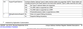

    3.Can TPS65987D  detect both CC with Rp pull-up Debug accessory mode?
    TPS65987D supports debug accessory mode and can detect this through the CC lines. This is configured through Port Config (register 0x28), bit field 7.

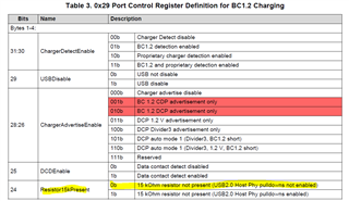

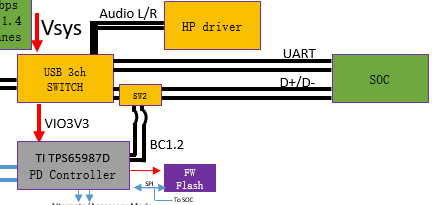

    2. Does DP/DN pin on SOC needs to be Hi-Z mode when BC1.2 detection  is  occurred?
    Please refer to this application note on implementing BC1.2 support for TPS65987/8 series: slvae17a.pdf
    Whether SOC DP/DN pin needs to be in Hi-Z mode when BC1.2 detection is occurred is not mentioned in the application note, can we assume it doesn't need a USB switch(SW2 in below PIC) when DP/DN of SOC not support Hi-Z mode?
    3. If SOC Hi-Z mode is needed but SOC not supported, can one of the TPS65987D GPIO be configed as USB switch control output to switch DP/DN out from SOC for BC1.2 detection? Will the below GPIO event ‘BC1.2_Host_Pull_Down_Enable_Event’achieve this function?
    If this GPIO event fit the criteria needed to indicate to the host pull-down/HI-Z state then it can be tied to one of TPS65987 GPIO pins. This is configurable through the Application Customization Tool which can generate the binary image needed to flash onto the PD controller.
    According to the Behavior note, this event seem to be used for BC1.2 Advertise mode, can we assume we need other signal to control USB SW(SW2) to switch USB signal from SOC to TPS65987D for BC1.2 detection if needed?

    Sorry for we didn't make the question clear. We are planning to use below connection in our design that 1) To program the new builded board's empty SPI flash in production line with external SPI host in the test station. 2) To update the FW with OTA update through SOC SPI. Will this kind of connection cause any unexpected error for TPS65987D? Especially when TPS65987D boot up whit a empty SPI flash and then program the SPI flash with external host.
    What is the state of DP/DN of the SoC (floating, open-drain, push-pull)? Since BC1.2 relies on the DP/DM resistance measurement if the SoC introduces additional impedance/capacitance on the line during the BC1.2 enumeration it could cause faults. If the SoC does not support Hi-Z check to make sure in Port Control (reg 0x29) the Resistor15kPResent [24] is set to 0b:
    Refer to the previous comment on the Port Control configuration.
    This shouldn't be an issue, on the EVM the TIVA microcontroller is also connected to the on-board SPI flash that is also connected to TPS65987. After the SoC loads the PD config into the SPI lfash the PD needs to be power cycled for the new config to be loaded.
