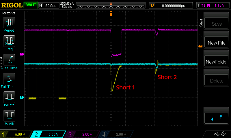

Hello
Is there some sort of minimum time between two consecutive short circuit events the TPS27S100 can recognize?
I have two very short short circuit events (~8µs) in my application, and for some reason the TPS27S100 only shuts down during the first one, but not the second one.
Here is an image of the short circuit events. Yellow is the output voltage of an H-bridge driven by the TPS27S100, cyan is my input voltage.
As you can see during the first short circuit the TPS27S100 switches the output off immediately as expected, therefor my input voltage does not drop at all.
During the second short circuit however the TPS27S100 does not switch off... Sadly I can't show measured currents with my scope at home, but I've used a current clamp yesterday in the office and the currents far exceed the set ILIM value of 0.5A. At one point I measured like ~8A or something...

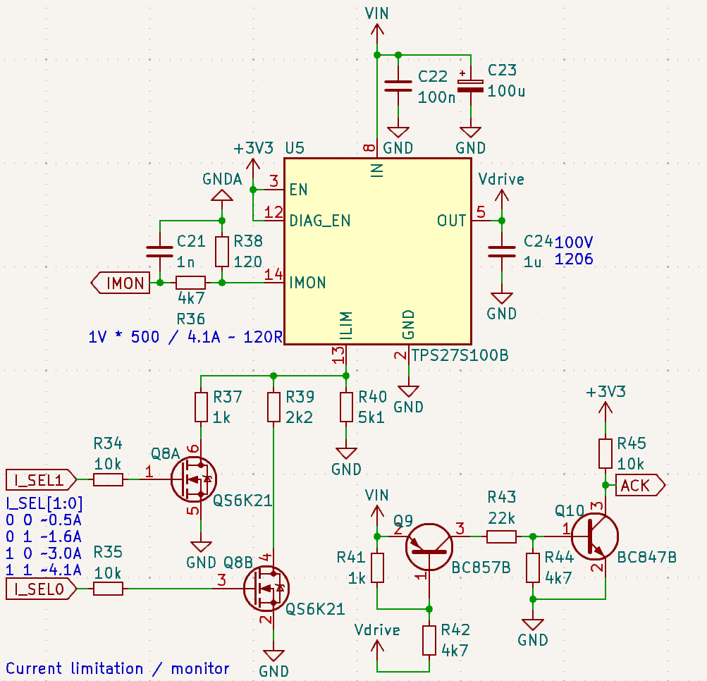

My application has the ILIM setting adjustable, but for that oscilloscope picture above I've used the 0.5A setting. The small transistor circuit below the TPS27S100 produces a digital signal whenever there is a large enough voltage drop between VIN and Vdrive. This voltage drop is what's causing the negative pulse of the magenta signal.

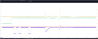

  • Hello Patrick
    I've managed to get hold of our current clamp. It's the yellow channel, 10mA/1mV.
    The first peak is around 570mV, the second one 1110mV.
    Other channels are:
    Red - GND
    Blue - input signal (and supply)
    Green - internal trigger for the oscilloscope
    Best regards
    Vincent

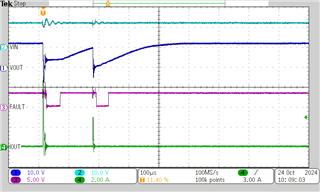

    Testing the TPS281C100 (next-generation of TPS27S100), the behavior looks as below (this was with ILIM = 0.5A):
    It looks like the short circuit when the output is (partially) on results in a very short spike about 2.5-3A (this is not unexpected, as the short-to-ground was through a very short/low impedance cable), then when the part reenables into the short, the current is limited to 0.5A properly. In both cases, the part correctly detects the short-to-ground.
    If the shorts in your application are weaker/have a bit more inductance and resistance, then the current peak won't occur and the part won't shut off before reenabling - it will just start limiting current to 0.5A.
    Does this look like something that can work in your application, instead of the TPS27S100?
    Thanks very much for your patience on this.
    Patrick

  • Hi Vincent,
    Sorry about that, in the rush I forgot to turn off the waveform labels and manually label on my response.
    Yes, dark blue is VOUT, light blue is VIN, magenta is unused, and green is IOUT.
    The load applied was a PWM'd MOSFET (<5mOhm on resistance), 10kHz switching frequency, 70% duty cycle. The same behavior happened at duty cycles, and at 6kHz at all duty cycles.
    When there is a short to ground, the device every time enforces the full voltage over it, unlike what we see in TPS27S100.
    Patrick
  • Hi Vincent,
    I tested a bit more with your above conditions:
    -Labels are correct (magenta is TPS281C100 FAULT pin)
    -Burst of 2 8us signals at 6kHz (~160us apart)
    -Load is the same, <5mOhm MOSFET PWM'd at the above condition
    -RILIM is set to 0.5A (the pulse is not long enough for the device to start regulating current)
    -The turn-on slew rate is fixed, and can't be changed - however, VOUT rises to about 85% of VIN in the ~160us between the shorts
    The FAULT pin doesn't always go low on the second pulse, but nevertheless VOUT always reliably drops.
    Does this part look like it will work?
    Patrick
