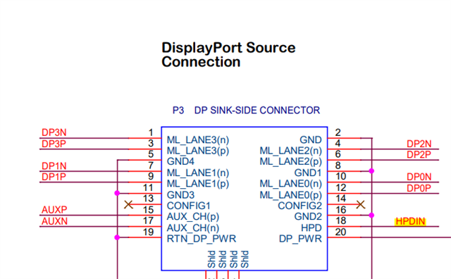

    I tested this board today and was able to pass video successfully. Here are the board settings I used:
    I had to drive HPD high using a jumper wire on JMP9. Please check that HPD is around 3.3V when plugging in your video sink.
    Here is the setup I made. Video passes from the PC, through the 1046 EVM, and to the monitor through the Type-C port.
    You need to drive HPD using a jumper wire, or the TUSB1046 will not pass video data. Please refer to the board image to see which jumper needs to be driven high. Can you try your test with HPD driven high and the board settings I used?

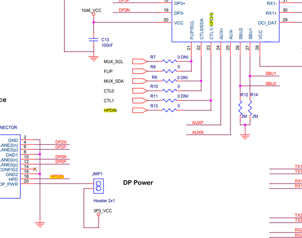

    Just to clarify, can you check whether R36 or R37 is installed on your board? These should be located on the bottom of the board and, if I'm not mistaken, share a resistor PAD near JMP9.
    I ask because R36 should be populated if you're using GPIO mode. That is the way my board is configured, but I realize this may not be the case for your board.
    Shane
    I just confirmed R36 is populated and R37 is open.

  • What voltage do you see on R13 when a display is plugged in to the type-C port?
    This should be at 3.3V with the display connected. I ask because this is the HPD signal that goes upstream to the PC. When the PC detects this HPD signal, it should show a display, even if video does not pass.
    Shane

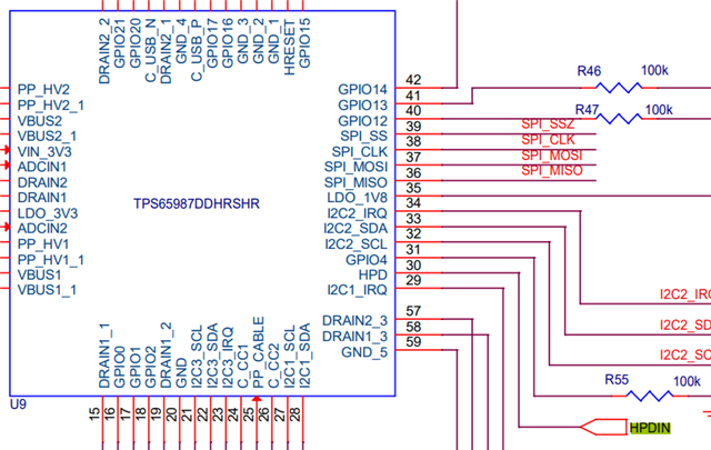

  • R13 shows 0V regardless if a type C monitor is plugged in or not. But HPDIN on JMP9 shows 3.271V.
  • This is interesting. The PD controller should be driving this signal high when a monitor is plugged in to the type-C port. Perhaps something is preventing this.
    For context, HPDIN on JMP9 will connect to the HPD of our device (TUSB1046). Its good that this is being driven high, but due to the board design this HPD is separate from the HPD signal that goes upstream to the PC. In order for the board to work in GPIO mode, both of these need to be high. This would ensure both our device and the PC can detect that a display is connected.
    The upstream HPD signal is directly connected to the PD controller's HPD output. When a display is connected via the Type-C port, the PD controller should drive this high:
    Applying an external pullup to 3.3V on this net may get the PC to recognize the display correctly. I can try and test this when I'm back in the lab later this week.

    For the DP only testing, can you please try the following steps?
    1. R7, R9, R13 un-populated
    2. R8, R10, R11, R12, R14 populated
    3. R36 and R37 should both be populated then you don't need the external jumper wire as the HPD from the PD controller will drive TUSB1046 HDP/DCI_CLK
    4. Leave USB unconnected on P1
    5. Have external 5V provided on J5
    6. DP cable connected to P3
    7. Type-C cable connected to P2
    8. Use a multi-meter check the voltage on the middle pin of J1. J2, and J3. You should see J1 and J2 both at 3.3V, and J3 either 0V or 3.3V.
    9. If you flip the Type-C cable, then you should see the middle pin of the J3 change from 3.3V to 0V, or from 0V to 3.3V. This confirmed the PD controller is working
    10. Check pin 1 of JMP9, it should be 3.3V, indicating PD controller driving the HPD high
    11. You should see the Type-C display at least being recognized
    If you don't see the display working, then I would like to swap the EVM with you and see if it solves your issue.
