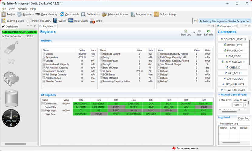

But I cannot find Chemistry tab if I select BQ27421-G1 in bqStudio.

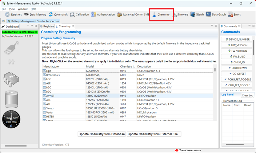

On the other hand, I can find Chemistry tab if I select BQ40Z50 instead.

- Screenshot of BQ27421-G1 : No Chemistry tab.
- Screenshot of BQ40Z50 : Chemistry tab exists.

  • Hello Chase,
    The BQ27421-G1 is a ROM gauge not a Flash gauge. One of the things that comes with the ROM gauges is that you cannot program whatever chemID onto the gauge, rather you are limited to only the pre programmed chemID (see table below). If you wished to program your own custom chemID onto the gauge or a chemID different than the preprogrammed chemID, then you would need to use a different gauge (one of the Flash gauges).

    The BQ27220 is a CEDV gauge and does not use custom chemIDs. You can refer to the Chemistry tab in bqStudio to see all of the chemistries we have characterized.
