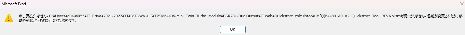

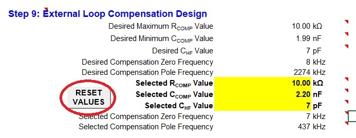

  • Hello Joshua-san,
    I am using  the design calculator. When I clicked the reset value for COMP value, the error message was shown. It seems that there are no file to calculate.
    error massage : "LM(Q)66480_A0_A2_Quickstart _Tool _REVA.xlsm" is not found as below.
    Would you please advise me to fix?  If you share the new version design calculator, it would be helpful.
    As another way, the datasheet describes the following value is used as initial value.  Is it okay to delete CHF value to apply the following value?
    Rcomp = 11kohm, Ccomp = 2.2nF,  CHF = not used
    Your advice is appreciated.

  • Hi Akihisa,
    Apologies, I may have sent the incorrect link, the one you seem to have is the LMQ66480 one. Please see this one here: https://www.ti.com/tool/download/TPSM6440X-DESIGN-CALC Please make sure that you have macros enabled for the calculator.
    Additionally, yes, you can change the values in the table and see how that affects your bode plot.
    I am not sure about the CHF value. I would stick to what is given by the datasheet if it matches your application as a first step. If you have an application that does not match any datasheet example, then I would begin utilizing the calculator to help validate your solution. In any case, TI recommends validating your solution on the bench as well apart from the calculator to ensure that your solution is sound. The calculator is meant to give you a good idea of what is recommended and will likely work when using our part as we have tested it.

  • Joshua-san,
    Although I downloaded and tried again, the situation was not changed.  The software tried to access to a0496455 PC, but did not work. I think that a0496455 PC is not power on.
    If it is possible to fix this cocurator issue, I am glad for all users.

  • Hi Akihisa,
    Can you please send me the file you were attempting to open?
    I can try and look internally and see if there is a fix, but I need to see the file to understand the error better.
    Thank you,
    Joshua Austria
  • Hi Akihisa,
    Yes I see the error now. I will reach out to the responsible engineer and look for a fix. In the meantime, I would suggest that you manually change Rcomp, Ccomp, and CHF to validate your solution as this may take some time.
    I will close this thread for now, but please feel free to open the thread again to ask any questions down the line
