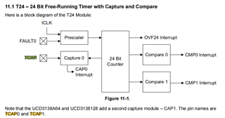

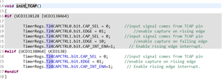

    I noticed that in "init_TCAP", there are configurations for the TCAP0 and TCAP1 pins, so their source also comes from "SYNC"?
    But what about FAULT0?
    Can you explain the function of TCAP? Or which sections of the code are related to TCAP?
  • You can find the code below to explain how TCAP is used.
    #pragma INTERRUPT(fast_interrupt,FIQ)
    void fast_interrupt(void)
                   prev_sync=sync;
    #if (UCD3138128 |UCD3138A64)
                   sync=TimerRegs.T24CAPDAT0.bit.CAP_DAT;
    #elif (UCD3138064 | UCD3138)
                   sync=TimerRegs.T24CAPDAT.bit.CAP_DAT;
    #endif
                   sync_delta=sync-prev_sync;
                   TimerRegs.T24CAPCTRL0.bit.CAP_INT_ENA=1;
                   TimerRegs.T24CAPCTRL.bit.CAP_INT_ENA=1;
    #endif
