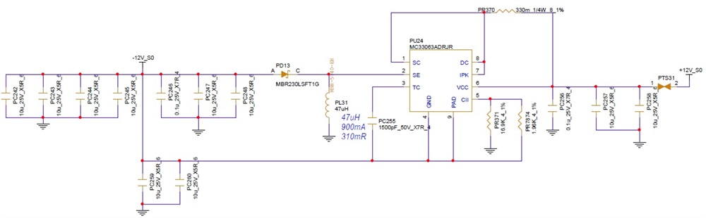

Dear Brigitte,
Based on MC33063A datasheet, the Current-limit sense voltage is 0.3V(Typical) and there is a 0.33 ohm resistor between the IPK and VCC pin. Then the current limit should be 0.3V/0.33ohm=0.909A. But our experiment result shows that Vout decrease when Iout over 0.15A. It is faw away from the current limit setting. Would you help to clarify it if any misunderstand? Thansk!

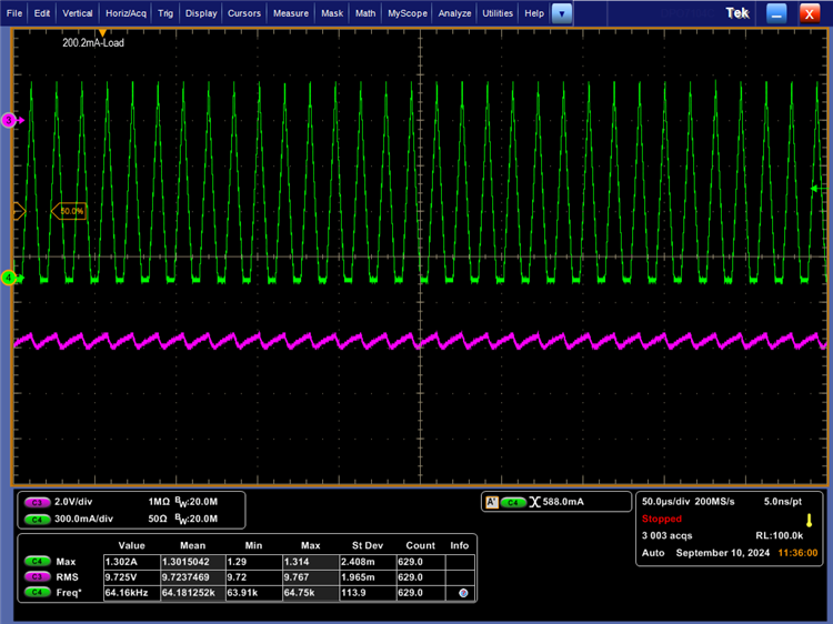

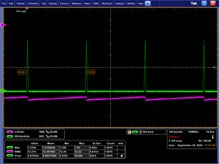

Sorry for late reply due to current measurement equipment issue. Please check inductor current measure result as below. Thanks!
Iout=0A Vout=-12.31V Voltage gap between IPK to VCC = 4.4mV
Iout=100A Vout=-12.14V Voltage gap between IPK to VCC = 51mV
Iout=200A Vout=-9.7V Voltage gap between IPK to VCC = 77mV
Hello Kevin,
To me this looks as if your converter is hitting current limit. The current limit is limiting the peak current. What happens if you reduce the resistor on IPK?
Another test would be to increase the inductance for a slower current rise.
Brigitte
Dear Brigitte,
We observed the voltage gap(Yellow and Purple) between VCC and IPK by scope. So I would like to confirm with you if the current limit happened in every switch cycle even in Iout=0A condition? Thanks!

Hello Kevin Hsu,
Please have a look at this app note: Application of the MC34063 Switching Regulator (Rev. B MC33063A behaves the same.
The device is regulating the switching with the peak current limit.
