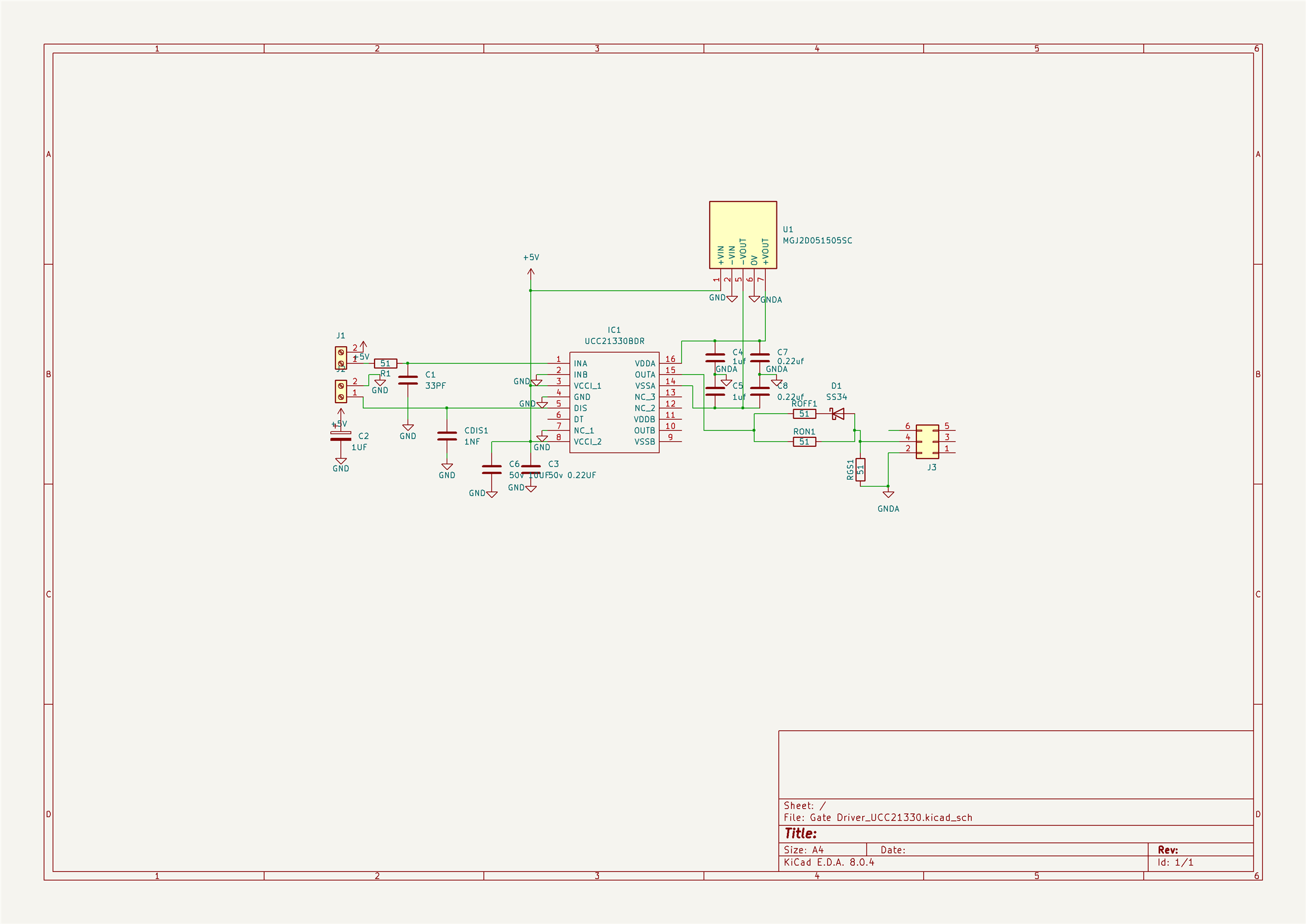

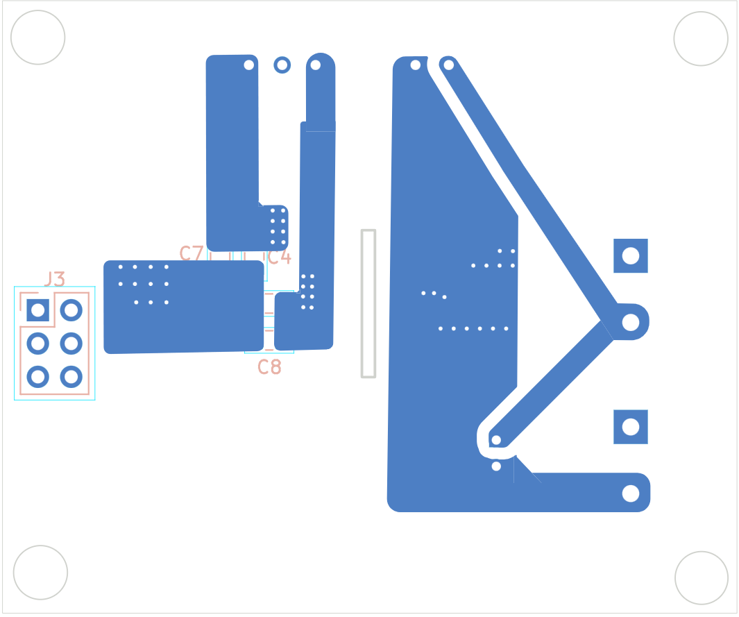

I have made a PCB for UCC21330 with isolated Negative Bias with Two Iso-Bias Power Supplies (Murata DC-DC converter). I am only using output A for driving a high-side or a Low-side Mosfet. I have very little experience in PCB design. I request that you please look at my PCB design and suggest any improvements required. I have attached the KiCad file here

  • Hi Sumit,
    If you only need one gate driver, you can use a single channel part like UCC23525.
    However, if you use the UCC21330, make sure to leave the NC pin floating, not grounded. Sometimes these pins can be tied to internal nodes for pre-production testing.
    You should have one capacitor from Vdd straight across to Vss, which will protect the gate driver from transient overvoltage better than two series capacitors. You only need one set of the series capacitors to decouple the bipolar supply.
    51/2 ohms is a huge Rg value. Are you sure you need this much? Typical values are 5-10 ohms, and sometimes even lower is better for switching losses.
    Sean
  • Hi Sean,
    Thank you so much for your answer.

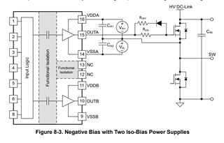

    Actually, I have followed the data sheet where, in an example of "Negative Bias with Two Iso-Bias Power Supplies," it was shown two series connected capacitors between VDD and VSS with ground in the middle, Is that not correct? Are the values of capacitors throughout PCB sufficient? is one set of capacitor between VDD and VSS enough? I have made a mistake in putting the value of Rg; it is indeed between 5 and 10 ohms. Can you please look at the PCB layout? Will it work? My DC link voltage is 1000 volts.
    Waiting for your reply

  • Hi Sumit,
    This capacitor configuration is for the negative bias using two isolated bias supplies.
    If this is not the case in your application, a capacitor between VDDx-VSSx is sufficient.
    As Sean stated before, we would recommend to use one of our single channel drivers if only 1 channel is being used.
    Let me know if you have any additional questions!
    Hiroki
  • Hi Hiroki,
    Thank you for your answer.
    My application needs  negative bias using two isolated bias supplies, so I have used this capacitor configuration. I am not finding any cheap simple single channel driver with an enable/disable function, and I already have this UCC21330, which is why I am using it. Can you suggest any single-channel driver IC with the same functionality? Can I not use the dual-channel driver as a single-channel driver?  Please look at my PCB layout. I am very new to PCB design and I need suggestions. My DC link is 1000 volts, and the switching frequency is 100 kHz. I have used a 2W Murata DC-DC converter with a bipolar output voltage supply (+15/-5V) (MGJ2D051505SC)
    Sumit Singh
  • Hi Sumit,
    Thank you for following up.
    Here is a device that could be a better fit: https://www.ti.com/product/UCC5350
    UCC5350 is a single channel isolated gate driver which would save space on your board. The complimentary input can be used as a disable function.
    For the board layout, refer to section 10 on the datasheets for layout examples and tips.
    The layout guidelines will be good to check.
    From a first glance, your board layout looks to be okay.
    Hiroki
  • Hi Hiroki
    Thank you for your suggestion. Next time, I will go for the single-channel gate driver. Since I have already purchased the UCC21330, I am planning to use it as a single-channel gate driver because of its low cost and simple functions. I just want to know if I can use the UCC21330 as a single-channel gate driver or not.
    Sumit Singh
  • Hi Sumit,
    Understood, thank you for the explanations.
    There will be no problems using UCC21330 as a single channel gate driver.
    Please feel free to ask any additional questions below.
    Hiroki
